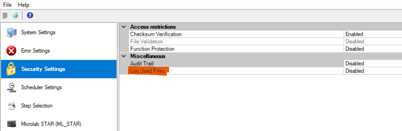

I think there is a setting somewhere in VENUS that you can turn on that lists all the labware/liquid classes etc that are used in the method at the end of the TRACE file.

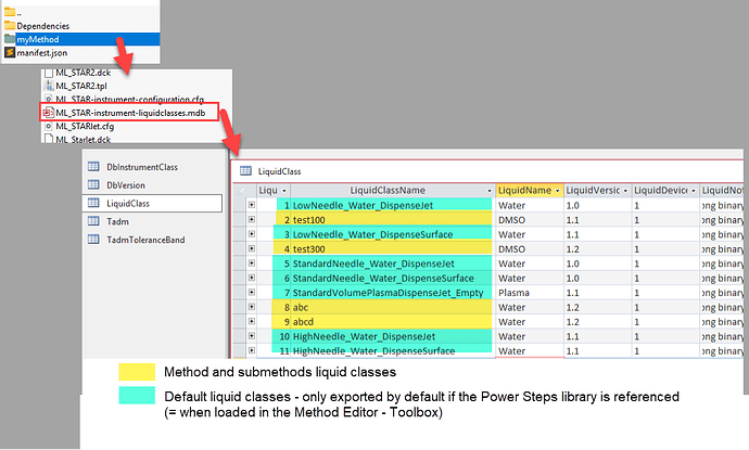

If you are on VENUS 6.2 or higher, you can:
  1. Export the method as .hamPackage
  2. Rename as .zip
  3. Inside the zip you can find an .mdb with your liquid classes
    The liquids in this .mdb can also be manually imported via Liquid Class Editor > File > Import Liquid Classes > select the .mdb
@ewanfyffe Thank you, but could you give some more details since I didn’t find any relevant settings in Venus, I’m using Venus 6.0.1

Here you go
