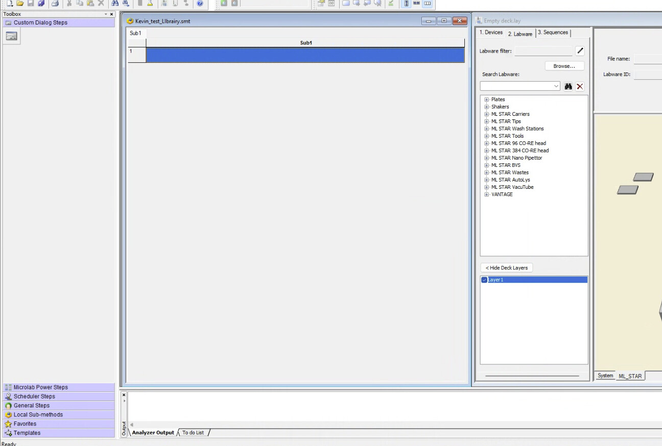

I played a bit with that and now I have a strange bug.

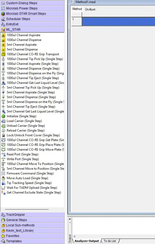

When I create a sub method librairy, the tool panel on the left is almost empty.
I do not see my ML_STAR, no gripper, almsot nothing:
I have tried to attach my deck to the librairy, load the librairy directly from a submethod but it remains empty. I also tried to load the HSLML_STARLib.hsl etc.

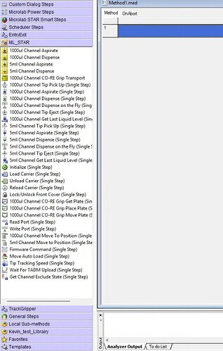

Normally, I would have that:

Got my answer by digging:
right click on the tab of the sub
Edit
add: instrument
ML_STAR
