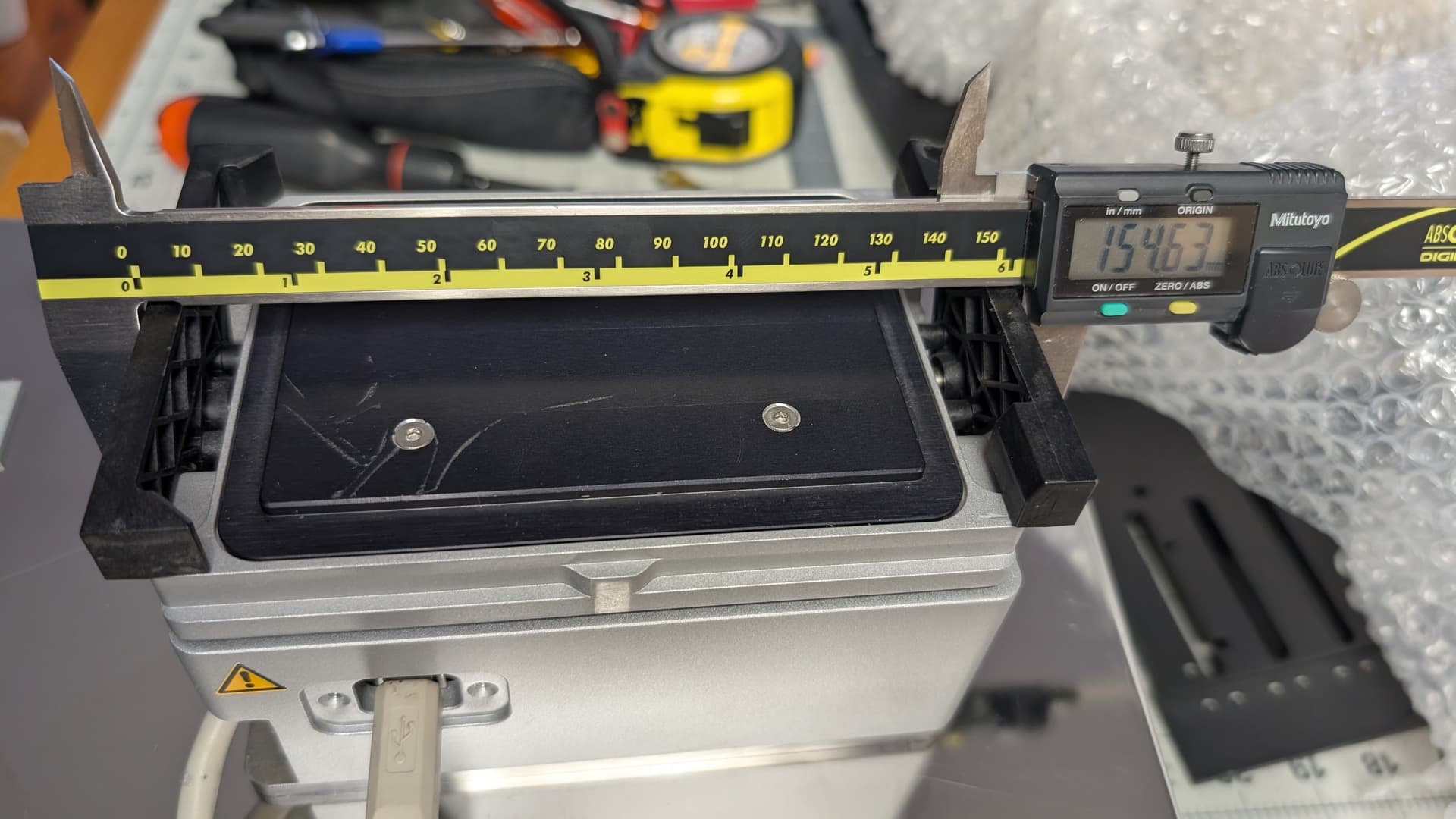

I did some testing on a unit I have. I drove the mechanism to it’s limit using the TXLS firmware command and this was the maximum result.
I would set them to open and check this dimension. If it isn’t quite this number you can use the TXLS or TXLS command to drive it to the maximum if the preset locations aren’t opening as much.
It’s not a lot of adjustment but may get you a little more.
