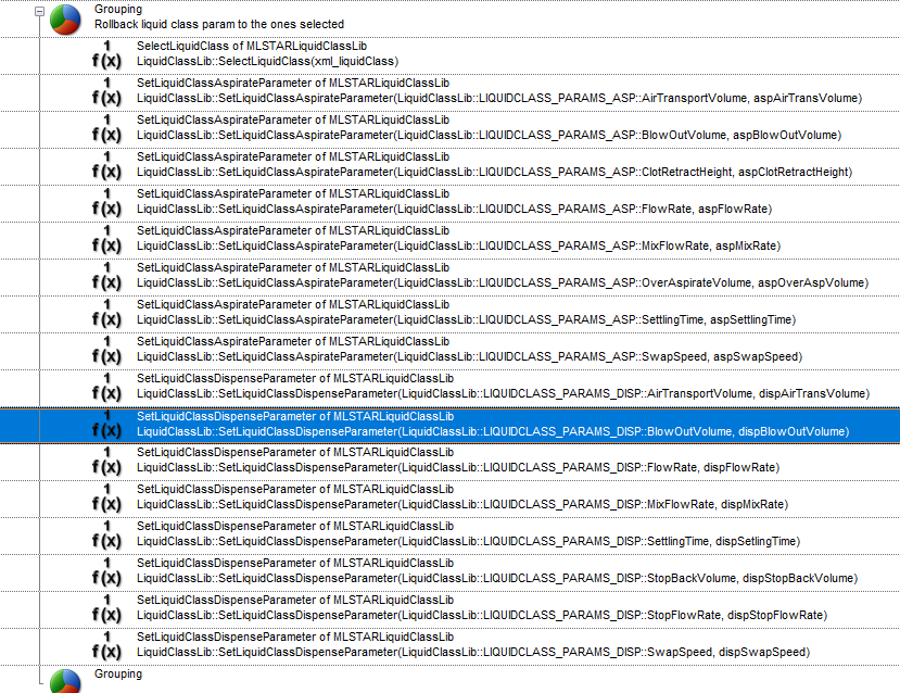

I think there’s a library in the LVK method that “rolls back” edited Liquid Class settings.
Maybe one application of this, would be in the method you define the liquid class settings you want. Grab a Liquid Class specific to your method to modify and then use. Hope that makes sense.
