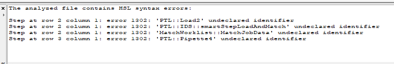

Hello everyone,
I’m encountering an issue with the HSL syntax, and I’m not sure where it came from. Everything worked perfectly yesterday, and today this problem suddenly appeared. I’ve attached screenshots and the library files. If you need anything else, just let me know.
I’ve already checked these files on another PC — everything looks fine there. We haven’t changed anything; to be honest, we don’t even understand how or why. We have VENUS 4.5
Lib.zip
The fix in this post should apply to your issue. Please let us know if it helps resolve it!
Thank you! It works. :smiling_face_with_sunglasses:
