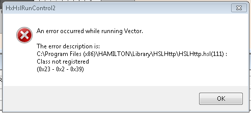

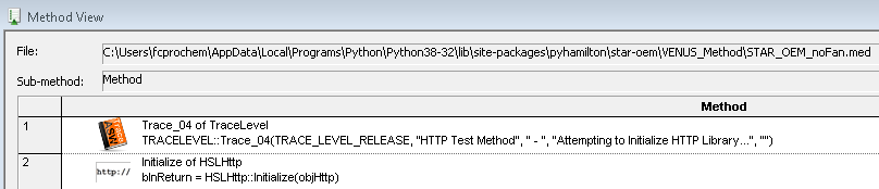

Hello, I’m having issues running pyhamilton for the first time. Whenever I try to run the “HSLHttp - Initialize” command, I run into the “Class is not registered” error below.

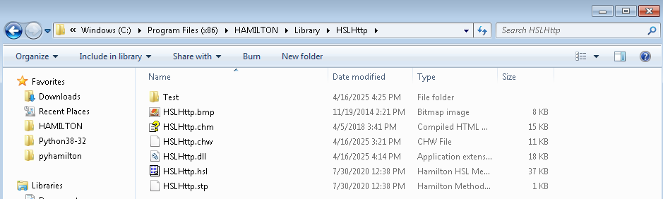

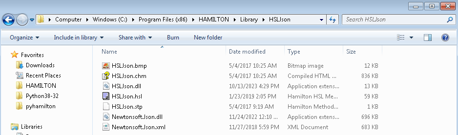

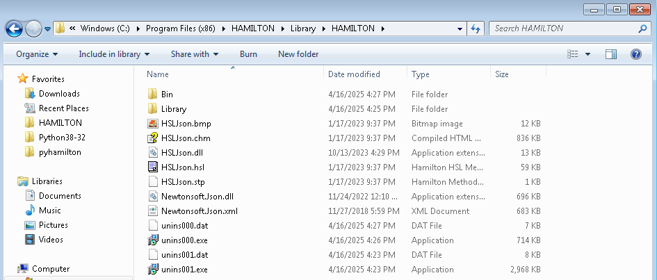

I’ve run the pyhamilton-configure.exe file numerous times and checked install locations. The HSLHttp files are located here: C:\Program Files (x86)\HAMILTON\Library\HSLHttp

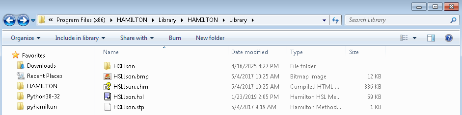

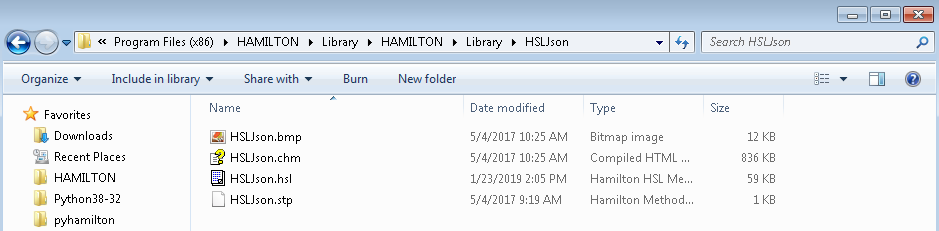

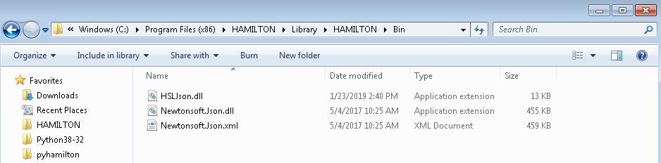

All other installers seemed to work fine. The only one I had trouble with was the HSLJson installer. I have multiple copies of all the HSLJson files throughout the C:\Program Files (x86)\HAMILTON\Library folder. If someone could confirm where these need to be, I can clean up my system lol. These are the locations where I have them:
