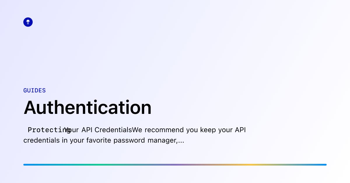

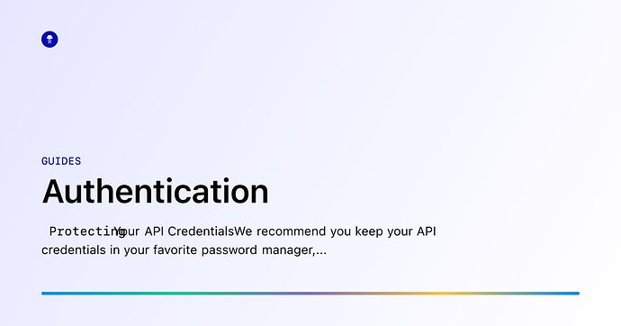

I have never used benching API, but the documentation shows it’s just typical basic auth or bearer token.
Problem hasn’t been resolved, and I tried doing both bearer token and basic auth as you’ve described/as described in the benchling API
