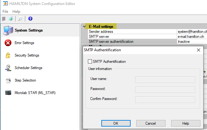

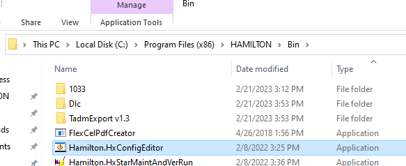

@tarun.chapman - The default values for sender address and SMTP server used by the HSLUtilLib email functions are set via the system configuration editor. The same library also has commands that can overwrite these values from default, if desired.
The config editor can be accessed from the method editor and run control toolbars:
Or you can launch it directly from the Hamilton Bin folder of your VENUS install:
In the system settings section, you will find the email configuration settings:
Admittedly, the currently available configuration options are not sufficient for sending emails to/from servers requiring SSL encryption and SMTP port configuration (like gmail), in addition to standard user authentication. However, this will be remedied in VENUS 6, which will allow for more configuration options and should allow for the ‘SendEmail’ command of the HSLUtilLib to function with such servers.

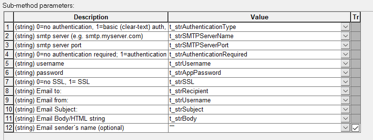

Below is a link to a custom library that facilitates ending emails via VENUS, through servers requiring various levels of security and encryption. Just paste the extracted folder from the zip into your Library folder.
SendEmail_SMT
Using a Gmail account to send automatic emails is a popular implementation in the VENUS universe, so I am going to demonstrate and example tailored specifically for that. Of course, there are highly varying IT restrictions out there, so your company may require use different email server. In that case, I would google the various server requirements.
Set up a Gmail account and use the following instructions to enable the mailbox to be accessed by third party applications. This will generate the password used for authentication.
https://wpmailsmtp.com/gmail-less-secure-apps/
Example screenshots:
If your team standardizes on a shared email account to use use for auto emails, the highlighted variables can be written into a modified version of the library (or pulled from the configuration or a file), to cut down on the number of required parameters. This would result in only needing parameters for recipient, subject and body (which would emulate the Util::SendEmail function).

For the new GMail account you set up for this purpose, did you enable emails to be sent via 3rd party applications, which generates a specific 16 character password to be used through VENUS?
Also, ensure all your parameters for the custom SendEmail function are of type string. Ex “2” instead of 2 for authentication type.
