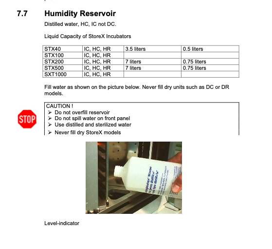

I wanted to discuss our current Liconic shaker-incubator, which is integrated into our platform. Specifically, I would like to address the humidity control feature of the model we have (StoreX STX44-HRSA). According to the manual, in order to regulate humidity levels, it is necessary to pour distilled water at the bottom of the incubator.
However, I am concerned about the possibility of undesired growth in this water.
Has any of you have attempted this method? Could you provide advice on adding any chemicals to prevent undesirable growth in the water without impacting cell growth experiments running in the same incubator?
