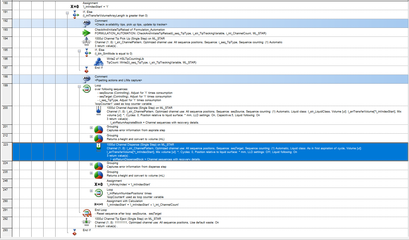

I’ve attached snippets of the loop that controls the aspirate/dispense, the trace file, and .csv file that the steps are read in from. Hopefully someone can provide guidance for this issue or see something I overlooked.
This loop is contained within another loop to process multiple buffers with the same code. The instrument picked up 8 tips as instructed, but then aspirated on 6 channels in remaining aspirate and dispenses. Obviously not all the code is shown due to limits in image size. More info here can be provided if needed.

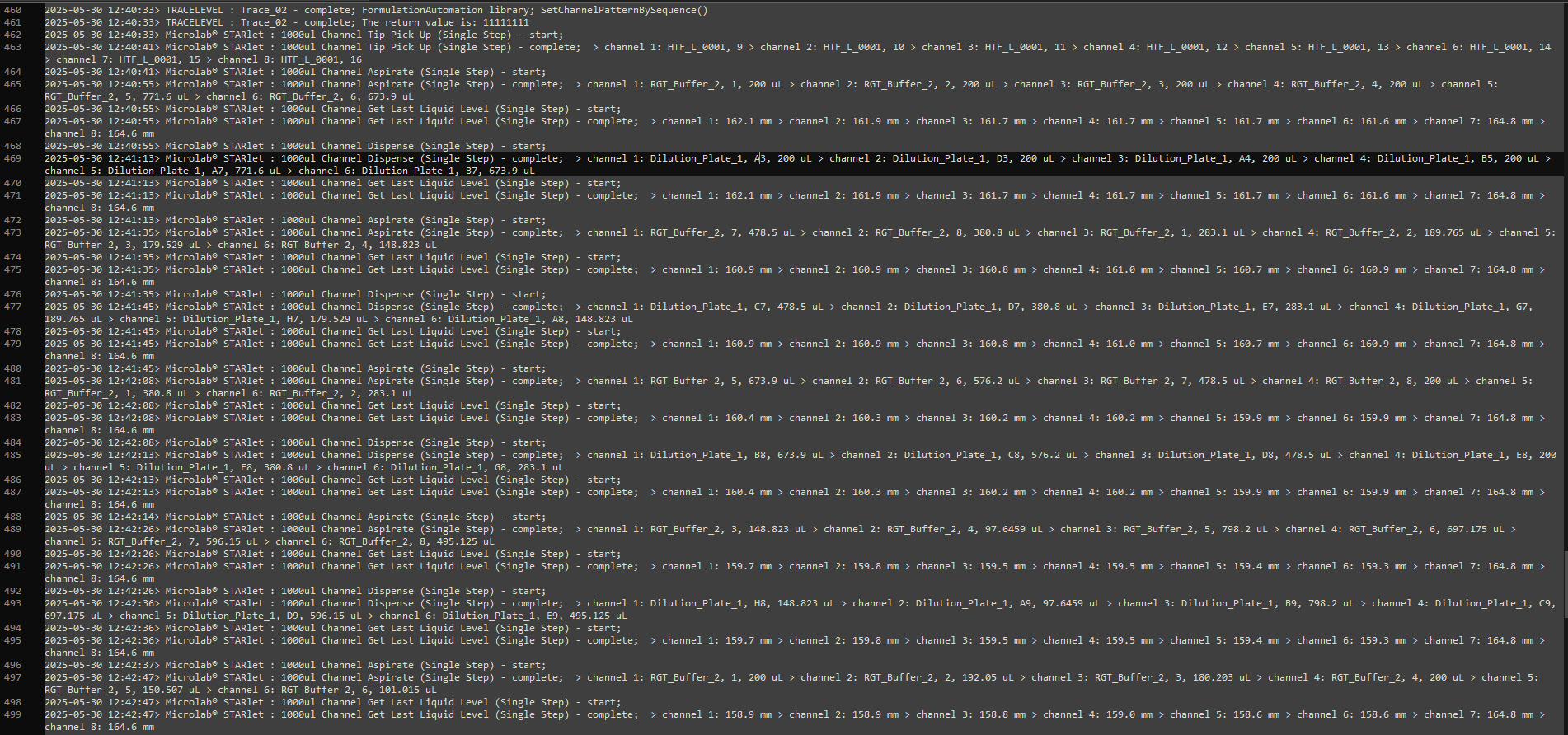

This is the trace file for the above loop when the error occurred. On line 473 we can see that channel 1 used the unused positions (RGT_Buffer_2, 7 & RGT_Buffer_2, 8) from the last aspirate instead of position 1 & 2 but the the correct volume of 478.5uL. This is where the position sequences became misaligned. This continued until an index for an array position was request that did not exist resulting in the fatal error.

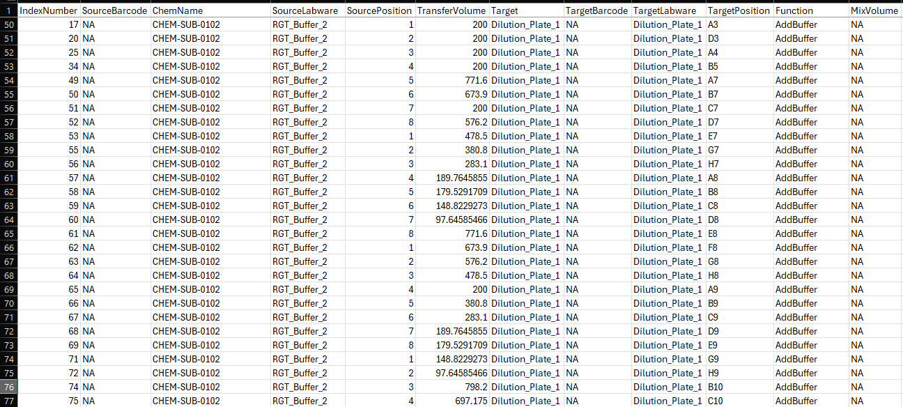

This is the CSV file read in to instruct the STARlet of the pipet steps. We can see that a RGT_Buffer_2 positions of 1-8 is request and should be processed in a group since we have 8 channels, but that is not what occurred. If we look at the volumes and example above in the trace file. The misalignment that occurred in the trace file (line 473) is a combination of index number 51 of csv that uses source position 7 and index number 53’s transfer volume.

In one project I worked on, the tips were also used in a similar way. However, I never encountered this kind of error after running the method for months. Therefore, I believe the issue might be caused by the settings in the “Loop” command.
Please uncheck “i_seq_TipType” in the Loop command at line 199.
In your case, I assume there are only 6 x 1000 µL tips remaining in i_seq_TipType after picking up the previous 8 x 1000 µL tips. Although i_seq_TipType is not directly used in this pipetting loop, it can still affect the channels used in the subsequent pipetting steps.
I have performed simulation runs and was able to reproduce similar issues.

This is very interesting. I agree that I should remove that i_seq_TipType from that loop as it’s not used. My recollection is that I was running low on tips, so it is completely possible I had 6 tips remaining. This could also explain why the issue didn’t occur on buffer 1 when the loop was run the first time but not the second time. I can’t recall if I replaced the 1000uL tips after this error or not, so that could be a reason the subsequent run worked.
