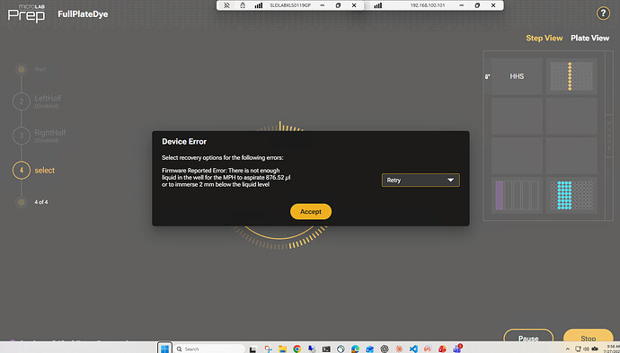

I’m having two questions, and wonder if I can get some help here.
  • Error handling. I was trying to alert on protocol errors mid-run. It looks like the API can’t see a pending firmware Device Error (the Retry/Cancel dialog, shown below):
  • global-run-state stays ProtocolRunning
  • check-for-pending-errors returns []
  • nothing in the /errors log
/errors only seems to surface Instinct-level errors (assay canceled, load failure, module not connected), not firmware Device Errors. Is there any way to detect these — a pending-view endpoint or a real-time (SignalR/WebSocket) channel? Or is it not exposed via REST?

Hi @PBI-HamiltonPrep-YZ, for checking for errors, you’ll want to subscribe to the websocket. Take a quick look at the Error Handling recipie on the developer portal for guidance on this.

Thank you so much @mrthorne, this was super helpful! Subscribing to the websocket did the trick — I’m now catching Device Errors in real time and firing off alerts without any issues. Really appreciate your insights and help.:grinning_face:
