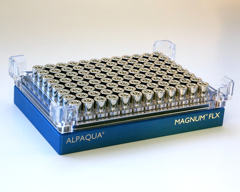

Hey @Pavel - this is not the best answer, but it depends on starting material and bead type.
We’ve had customers use the Alpaqua Magnum FLX if their samples are taking too long to bind with good success in the field in a DW plate.

Hey @Pavel - we’ve found the EX isn’t strong enough for some of the bead cleanups as well, same with the 96S depending on volume of beads. I’m referring to this magnet:
