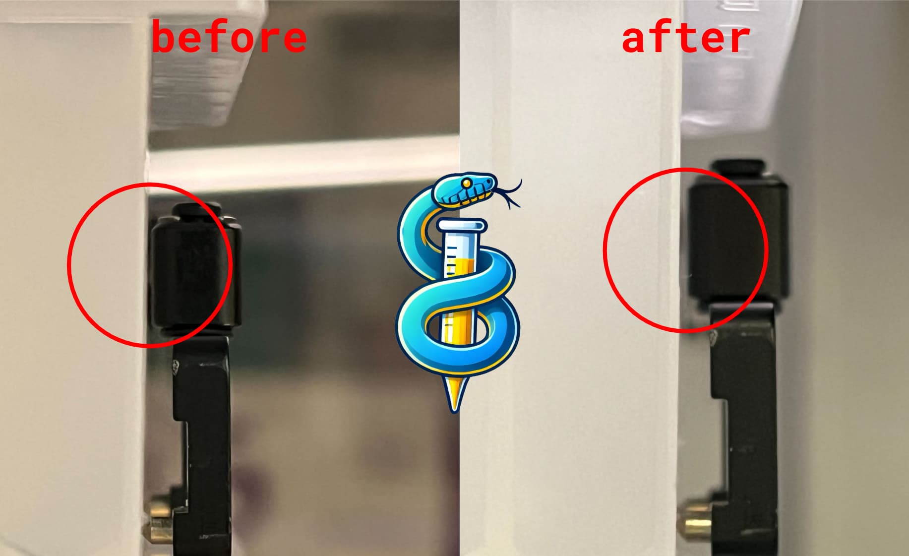

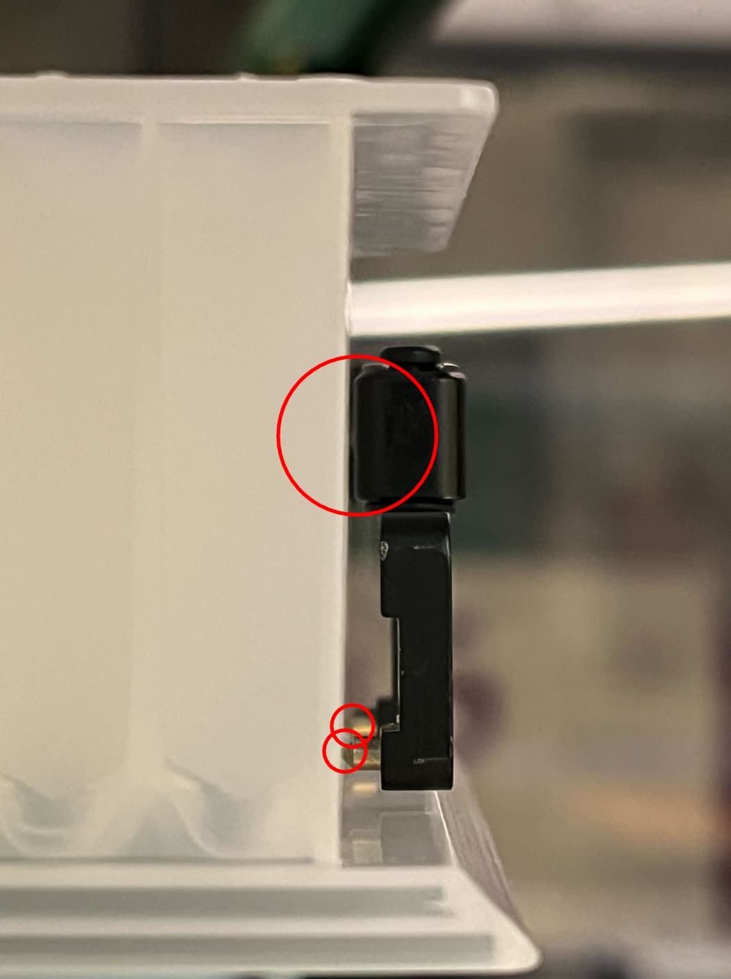

I notice while gripping tall vertical surfaces, the two smooth metal sides of the iSWAP hand contact my plate more narrowly than the metallic fingers themselves. the plate rotates in the iSWAP grip & cause crashes
in this application, I require to grip the middle of the plate rather than the top of the plate, as the plate is going into an external hotel location with limited Z axis clearance (vspin centrifuge). so the metal sides of the iSWAP leading up to the gripper itself need to be below the top of the plate to fit in my centrifuge
has anyone troubleshooted these tricky constrained gripping scenarios?
grip & plate in question:

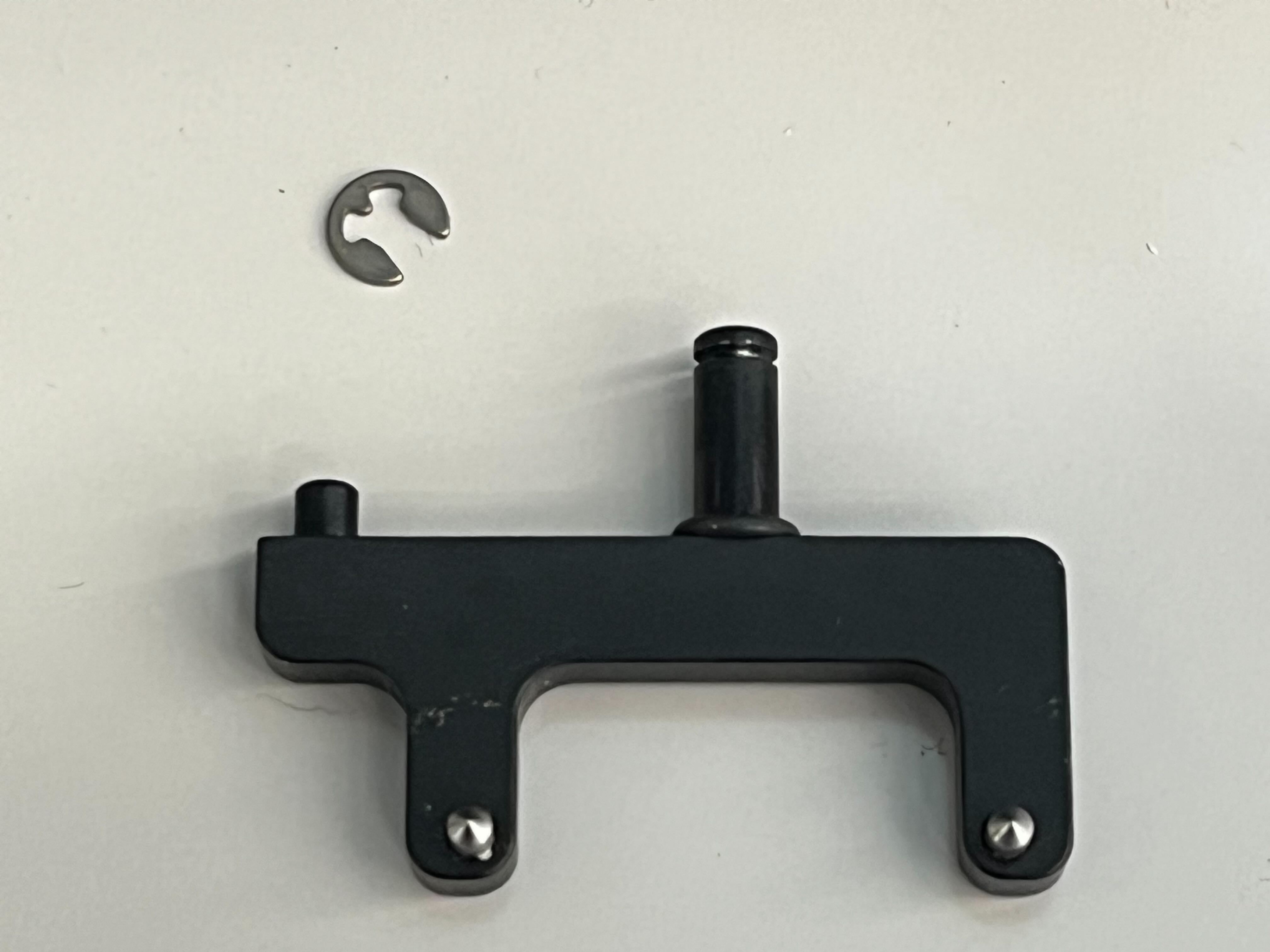

if I can replace these gripper sharp-points with ones that are 1-2mm longer, it seems all my problems are solved. is this the best solution?

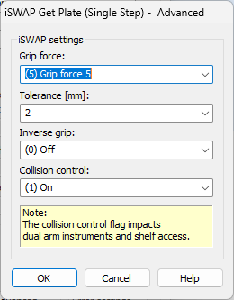

You could try optimizing grip force and see how much it squeezes your plate, and how secure it is when moving the labware.
It might be what you have is the best settings already though without changing the hardware.
looks like the gripper ends are easily removable - i’ll CNC a few different versions & report back the best solution
I figured out how to resolve this problem with a simple mechanical adjustment of 8 screws & wrote a tutorial here
Make sure the points on the pins are sharp.
Sharp points = less grip strength needed to bite into a plastic plate
