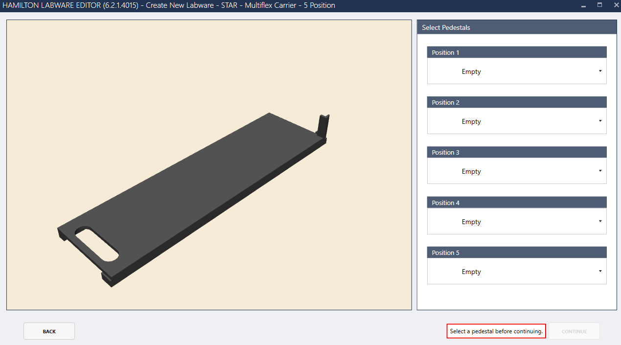

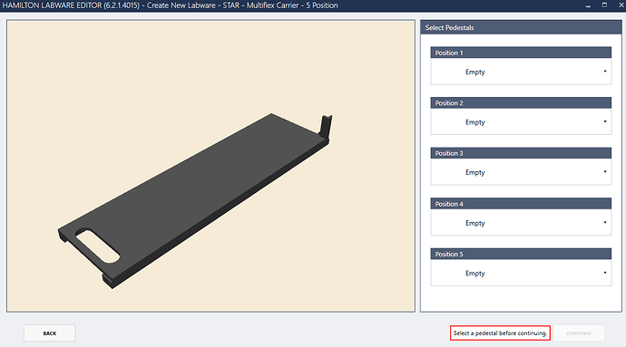

I’m trying to use the Labware Editor to create new MultiFlex Carrier definitions on my laptop but am unable to do so. I’m currently running VENUS 6.3.1.1147 on my laptop. I navigate to System Tools > Labware Editor > Create New Labware > Microlab STAR/VANTAGE > Multiflex Carrier > 5 Position P/N: 188039 and then Labware Editor force closes itself. Has anyone experienced this problem, and what is the fix? Thank you!
I would suggest taking a look at the Windows Event Viewer logs for any signs of the application crashing and its faulting modules. My guess would be that it has to do with DirectX or a similar graphics-related driver as the point at which you are experiencing the crash is when a 3D model is loaded into the Editor to begin selecting the individual MFX modules. I will also note that this is the point in the dialog that I’ve noticed a small delay between switching from one window to the next.
Alternatively, it could be due to folder permissions as the drop-down lists are populated from files existing in various Hamilton subfolders.
Hi @DanHartman_Hamilton, it makes sense that Labware Editor is crashing when a 3D model is being loaded because I’m also having trouble having the 3D Deck Mode in Method Editor. I get a “Class not registered” error and it automatically switches to 2D mode. How would I fix this? Thank you!
Check out this post or this post from @BrandonBare_Hamilton and or this one from @NickHealy_Hamilton to see if there’s a DirectX installer in your installation media for your Venus version (or from Nick’s post) and see if you can repair that functionality that way.Not sure to be fair if there’s a different version of the installer for the Venus version that you are running.
