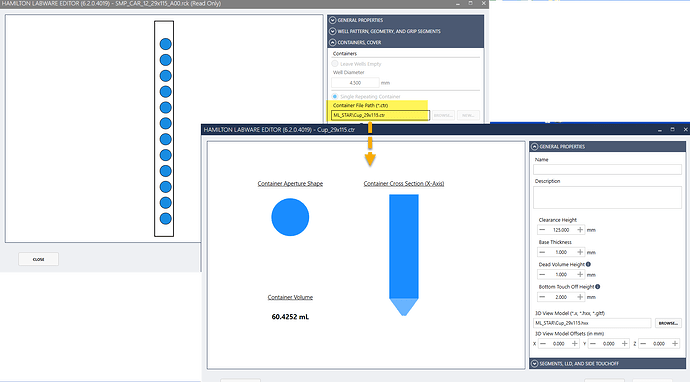

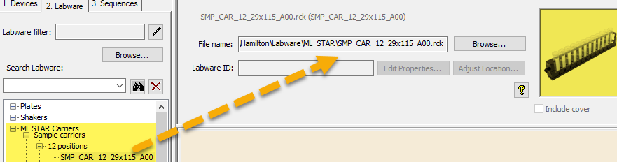

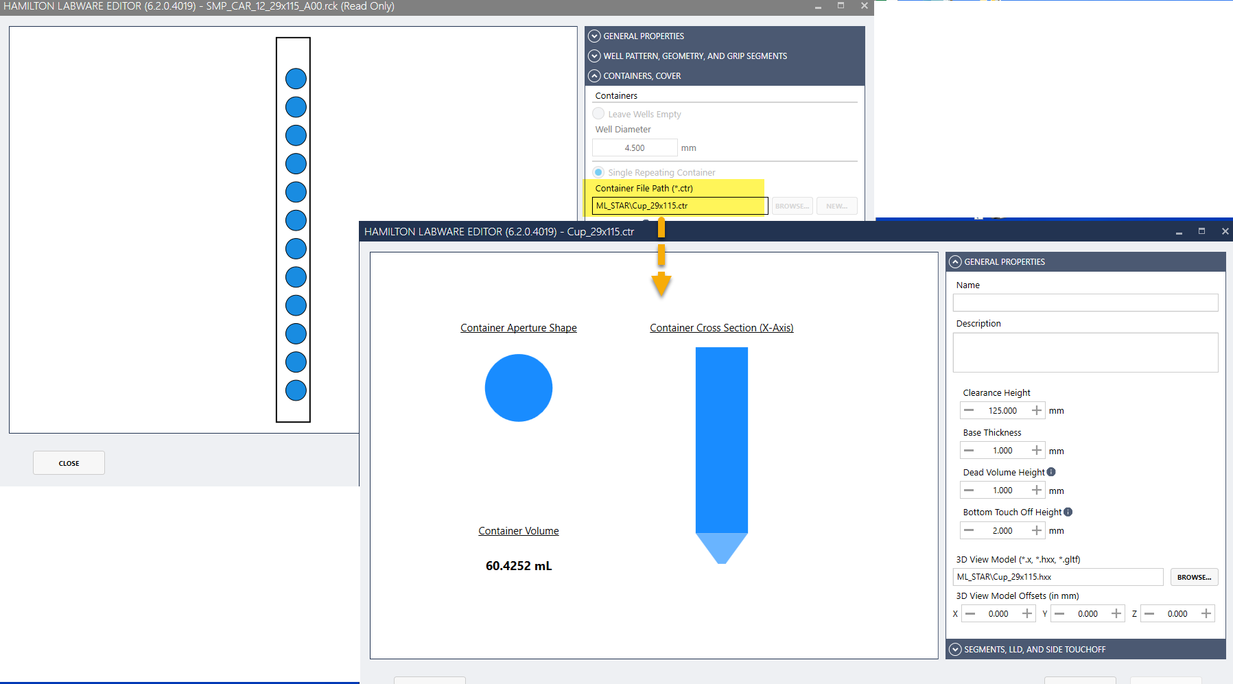

50mL Falcon tube definitions install default to VENUS, typically used with a 12 position autoloadable sample tube carrier:
The tube container (ctr) definition for standalone use in a different rack can be found at:
C:\Program Files (x86)\Hamilton\Labware\ML_STAR\Cup_29x115.ctr
