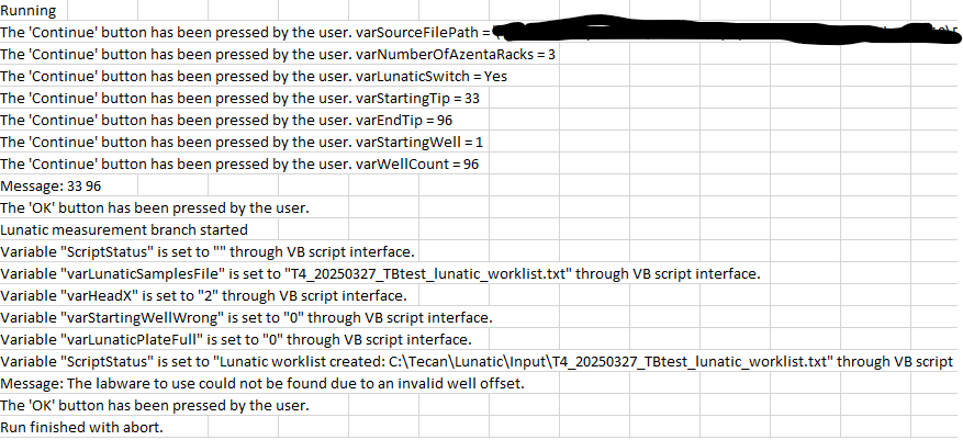

With issues akin to this one it’s always great to know what the system is seeing, are you commenting the variable values into your AuditTrail? What do they return for your use cases?
If the hard coded integer values are working, you may be returning a value that’s off.
The other option is that your script is “validating” and throwing an error with whatever varHeadX and varStartingTip have as their default variable values but that would be weird because it would show up when it compiles the script in the script editor.
Yes, its visible in the auditrail:

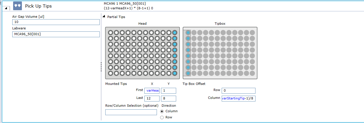

I assume the value from varHeadX is used in the formula shown here:
which theoretically should be working with value 2, since tips are starting at column 5…
As you say, its not compiling issue. Below is the part of the VB script that passes the value…

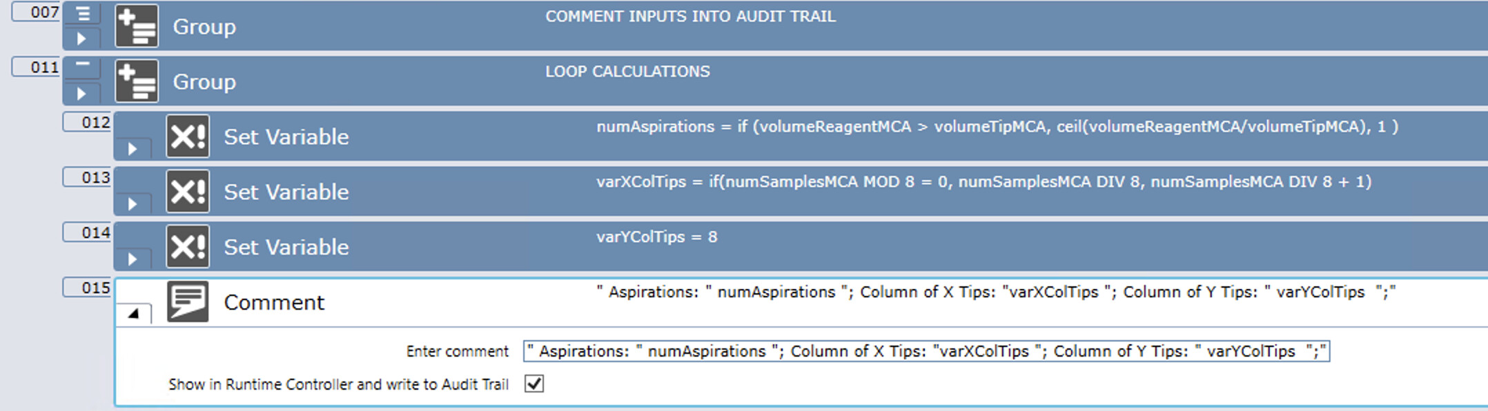

May be good to audit the values in the boxes of your Pick Up Tips Command by creating an additional variable that contains this business logic and then using comments to have those values displayed in the audit trail. If you use this logic a lot, I recommend making it into a subroutine.
The error makes me think that this is resolving into something where the Fluent is trying to access a tipbox group-adjacent to the tip box selected, e.g. TipBox[000] instead of TipBox[001].
You could try populating TipBox[000] thru TipBox[002] and target TipBox[001] to see if it is accessing other labware within the group. Also you could try simplifying the VBscript to just pass 2 without the math to isolate the variable handoff, telling you if this is something within FluentControl or not.
I would try to select all 96 tips (Head & Tipbox) in the graphic and apply the offsets by variables onto that graphical selection.
Because now there is an column offset already by the graphical selection and another offset by variable which may be added on top of that. And if the column offset becomes >12 or <0 FC tries to move to the next tipbox with index 002 or 000 as per evwolfson’s post above; which could fit the error message that the labware wasn’t found.

I haven’t used it because of the short formula showed in the header of the Pick up tips command (12-varHeadX+1) which is the same thing, so I didn’t want to double it. But for some reason it works now.

My experience with automation & control software is to log everything. Any input value, any transformation, any action, any bit of code → Just Log It.
Here’s an example below of how to do that for FC,
Note how my values, even the hardcoded values, are commented into the Audit Trail. The variables that you don’t see here are commented into the Audit Trail in the group above this group.
I also made this into a subroutine that I can use over and over again and since the inputs can be quite variable, I want to log as much in the Audit Trail to troubleshoot in the future.
