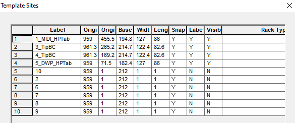

This came up recently for me too! The correct nomenclature that worked was β€œX=[Label]” where X is the position location of the carrier and β€œLabel” is the name of the position that should map to the Label column in the Template Sites of your .tml file. So for example, say you have a carrier with these labels
The MlStarReadBarcodeOnPositions property that corresponds to this carrier would be β€œ1=1_MIDI_HPTab;3=3_TipBC;4=4_TipBC;5=5_DWP_HPTab;”. Note that this example carrier has an empty position 2, so the property does not explicitly call out an assignment for X = 2.

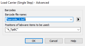

Then when calling the Load Carrier step, in the advanced tab, you enter the Label of the labware that you would like to scan at that position:
