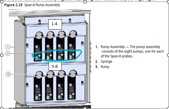

This should theoretically be covered under your service visit too, but have you checked to see if the thumbscrews in the syringe bank are tight? We had a similar issue, and making sure the thumbscrews were tightened completed removed the problem. We check these on a monthly basis and tighten. They definitely came loose at least ~ 6 months after our last PM.
Thank you both for those suggestions! I checked the supply lines and they feel snug, so I’ve ruled that out. I’ll take another look at the ends of the tubing in the mandrels to see if they need reseating as well.
I’ve also ensured the thumbscrews are all finger tight, we did have one become loose last month that we tightened before we saw any issues. This is seen almost exclusively with high volume tips (1025 filtered) which we mix ~500 uL at most.
It’s really not a bad idea to take the whole pump bank cover off (the light blue highlight in @UCantBcereus’s pixture) to access and visualize the syringes better. It’s just 1 screw to remove and 6 screws to loosen and you can access inlet/outlet connectors, syringe to valve, and thumbscrew to syringe plunger a whole lot easier.

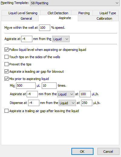

We do the same exact kind of mixing with the same tips for one of our scripts. Its been a while since we used it, but at the time the instrument was installed and we were working on the protocol, we ended up doing 2 things that I think helped with this.
  1. Rather than use a loop of 10X aspirate/dispenses, we used a 0 uL aspirate step, and Used the “Mix prior to aspirate” option to mix the 500 uL there. We ended up aspirating at 100 uL and dispensing at 250 uL/sec. I think it was a way to get the Biomek to actually allow the higher dispense speed without getting a firmware error.
  1. After each of these mix steps, we had to drop tips and run a “Wash Tips” command. I don’t remember the reason why this occurs, but it was explained to me that mixing large volumes fast can effectively collapse the STAG in the SPan-8 pod, which would lead to leaking of the system liquid. Adding in the “Wash Tips” command seemed to be a way to “home all axes” and return the liquid lines to a good state/reestablish a STAG after the mixing.We saw leaking when mixing at those volumes until we added that in.This was ok for us since it was for sample dilutions, and we needed to use new tips anyway . Looking through the script, I even see it in other spots after we mix smaller volumes as well (125 uL). This wouldn’t work if you wanted to use the same tips after the mix step, such as a serial dilution. It also adds to the runtime, if what you’re doing is very time sensitive.

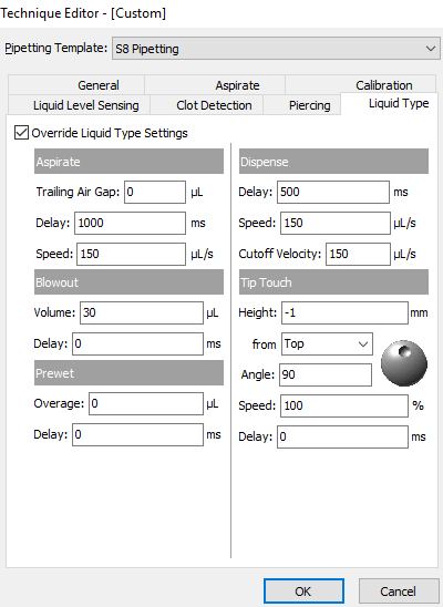

I have been advised by Beckman that slow aspiration and fast dispense speeds are optimal so we are using these in our methods. They have improved things but we are still experiencing issues.

I reduced aspiration speeds to below 120 across the board. This helped since my system has 250 ul syringes and low volume tubing, so there is less pressure from the tubing.
