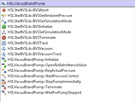

Hey there,
would it maybe possible to add a Library for the BVS and a demo method to the folder.
The driver/setup files if required would be a great help as well.
Thanks in advance.
The libraries to control the vacuum carrier are included with VENUS by default. There are two libraries for low level and high level commands. The low level commands essentially just control the vacuum pump while the high level commands control the entire device and enable the use of sample tracking for the vacuum controls. The low and high level commands should be used separately from each other.
Add the HSLVacuuBrandPump library and you will have access to both sets of commands.
I uploaded an example method here.
Thanks for the quick reply and the demo method, must have overlooked the library yesterday.
This unlocks the wonderful world of solid phase extraction for me :smiling_face_with_sunglasses:
