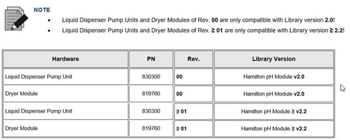

If anyone has access to the library for integrating the Hamilton pH module could you please post it or send it to me at stefanmgolas@gmail.com? Thanks
I can assist, but please note that the library version you use is dependent on the revision number of the modules. I uploaded both to the shared folder here.
