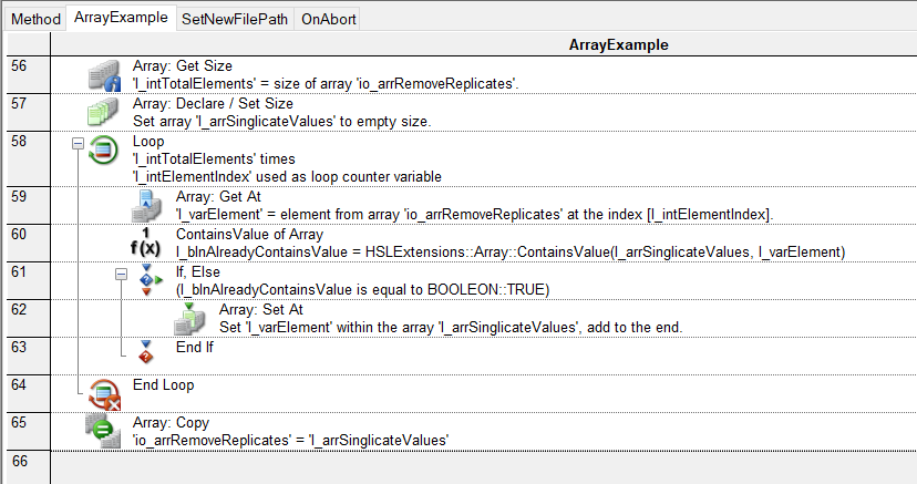

@EricSindelar_Hamilton can you add the unique array library? It’s the library where an array of variables is inputed and it removes the duplicate data. Thanks.
@chips-a-hoai I am not aware of an HSL library that performs that function as is, but I have performed that functionality with the following example code. This can be re-used functionally through a local submethod or SMT library.
Pass the original array which may contain replicate element values into a submethod (method or SMT) as an in/out array of variables parameter:
Use the following logic to parse the array, only retrieve values that are unique, store into a temporary array, and then copy to overwrite the original array to only contain elements of unique values.
This uses the ā€˜ContainsValue’ functions of the Array library which installs with HSLExtensions, linked above, which queries an array as to whether or not any of its elements contain a value. This submethod will yield what you are after.
Hope this helps you!
