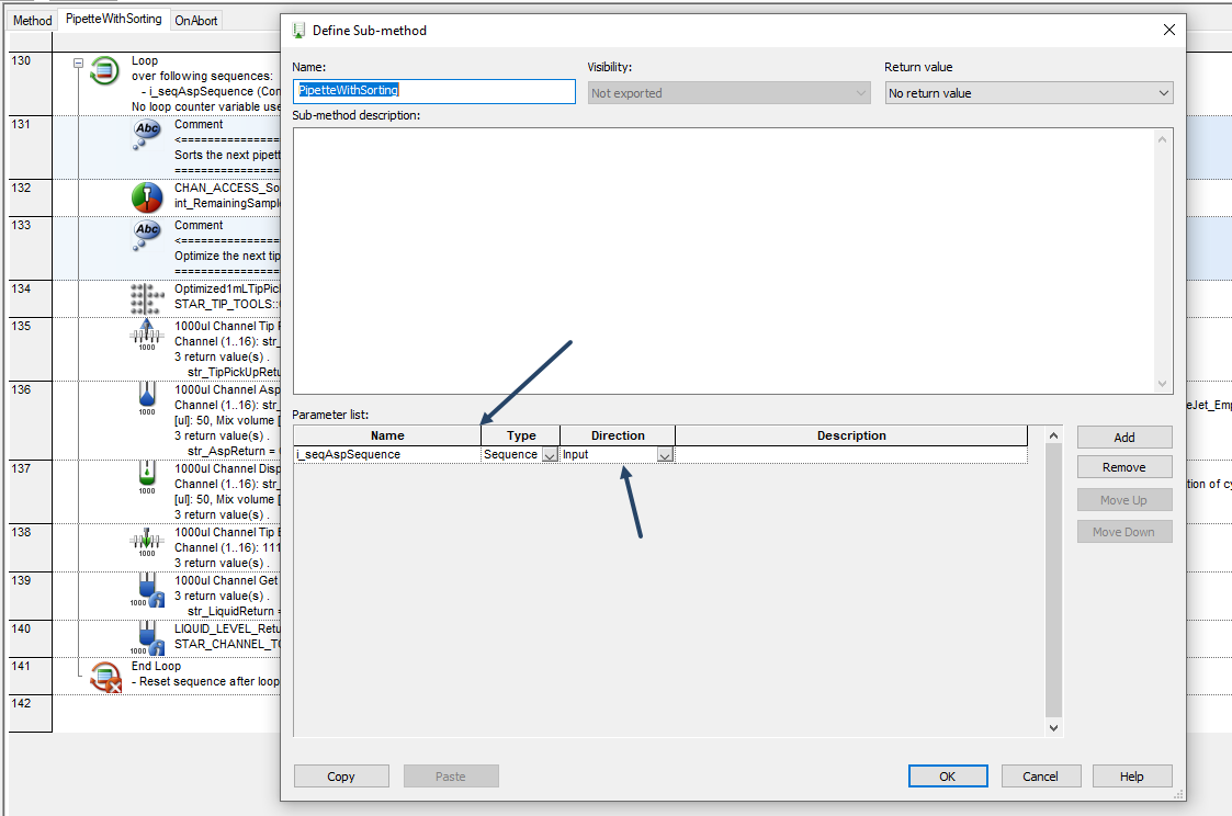

The CHAN_ACCESS_SortSequences functions will remove sequence positions as they are used. This is what allows the library to sort and come back to any position that a channel cannot reach. The result is the sequence being used will be empty. So, the first time you reference the sequence it will work as intended, but the second time it will pipette nothing because the sequence has been drained.
There is an easy work around for this, however. Placing your pipetting steps that use the sort logic within a submethod allows you to pass the sequence in which will create a copy. This will maintain the original sequence for future use. See below:
Note that the direction needs to be set to Input not Input/Output.
Another option would be to make your own copy prior to pipetting using the SeqCopySequence function.
