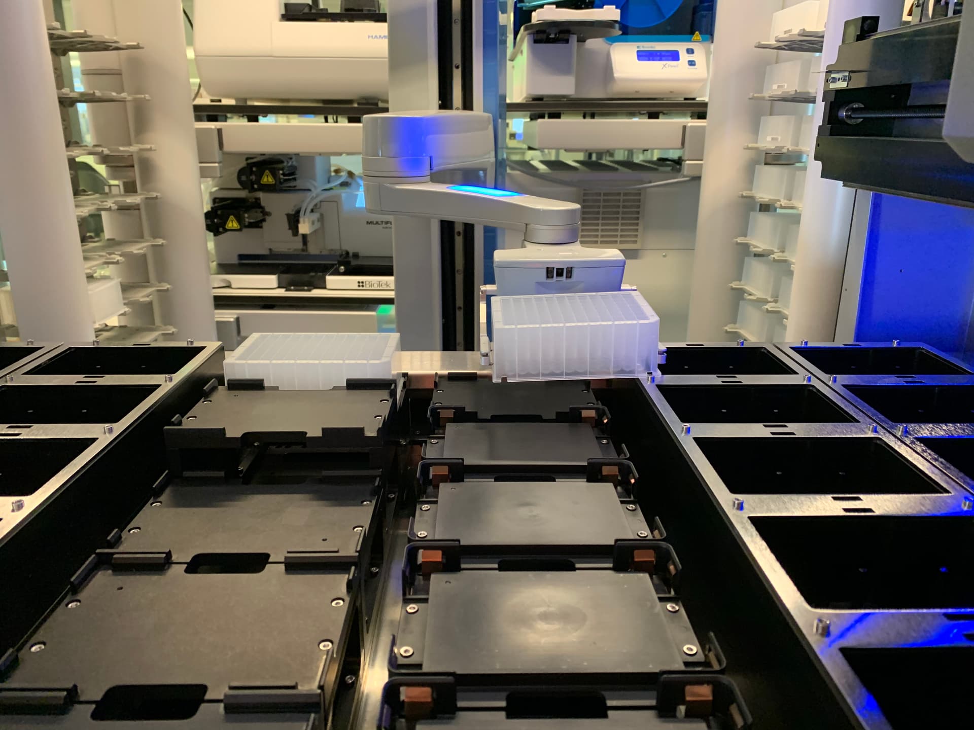

The “vision teaching” feature is mostly marketing hype—it works for basic needs but not for more complex scenarios, like teaching a nest on the carrier of a Hamilton STAR. In the example below, it was a real struggle: the grippers weren’t strong enough to hold the plate, so you had to squeeze them with one hand while guiding the robot with the other. This was made even more difficult by the dense arrangement of surrounding instruments.
One thing I do like is that the Spinnaker is sold as a bundle with an adapter plate, letting you add hotels and instruments without drilling into your table. This makes it easy to set up a reader–feeder workcell if you have basic automation skills, and you can repurpose the robot for other applications as your needs change.
For more complex systems, I’d recommend the Precise Flex—it’s significantly more robust. Thermo will sell it to you, but they won’t tell you that up front. The robot they put on a track has a very limited vertical reach, meaning the overall system ends up being much larger than one built with a Precise Flex arm.
