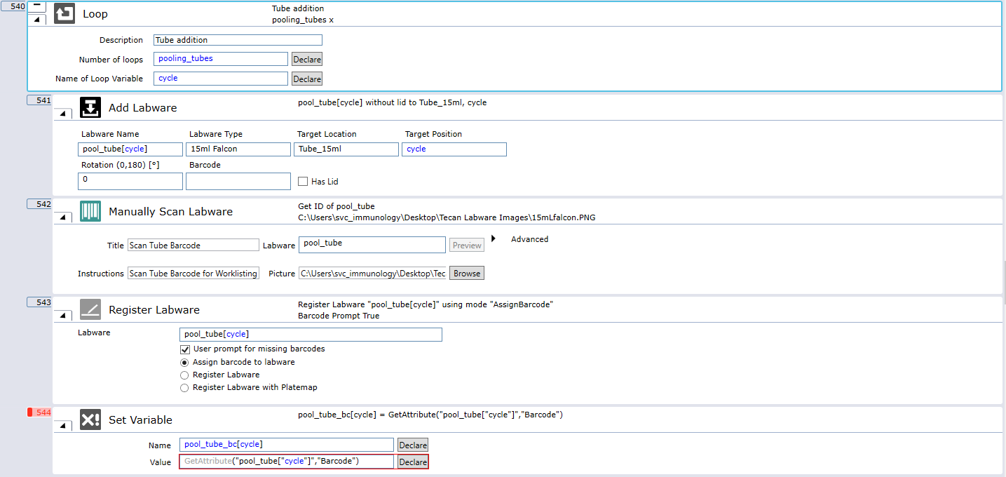

I am attempting to add in a variable amount of tubes for my workflow and have been able to do so successfully before but have never done it with the registration of barcodes into variables for the reporting that we do at the end. The specific problem is coming from the set variable command as I am trying to get it to include the loop command that I made. I have already turned the string variable into an array to attempt and store the variable values from it but am still getting an error. Any assistance would be great.

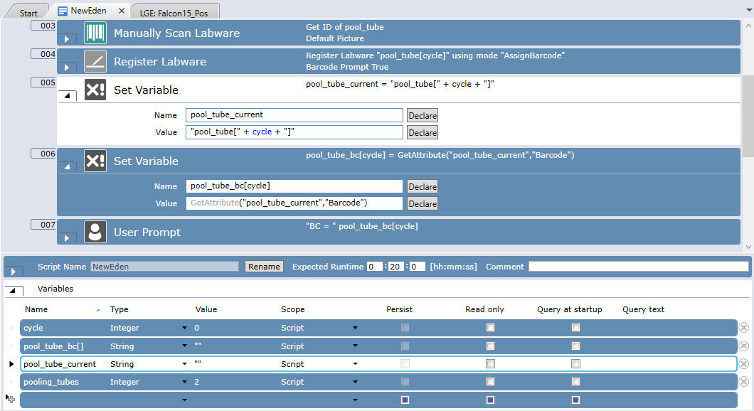

The problem is that within the „GetAttribute“ Function, the content enclosed by quotes is only interpreted once, taken literally. So what the GetAttribute function „sees“ in your script is pool_tube[cycle] while it should be seeing pool_tube[1], pool_tube[2] and so on. One fix is to declare a new string variable within the loop, removing the need to interpret the variable array index counter „cycle“. Check this example where I named the new string variable „pool_tube_current“:
So the content of pool_tube_current is holding a string concatenation forming the string you need for the GetAttribute function.
It worked in simulation, hope this solves your problem!
Hi Leon, thank you that seemed to work excellently, I am currently testing it on instrument for our purposes.
