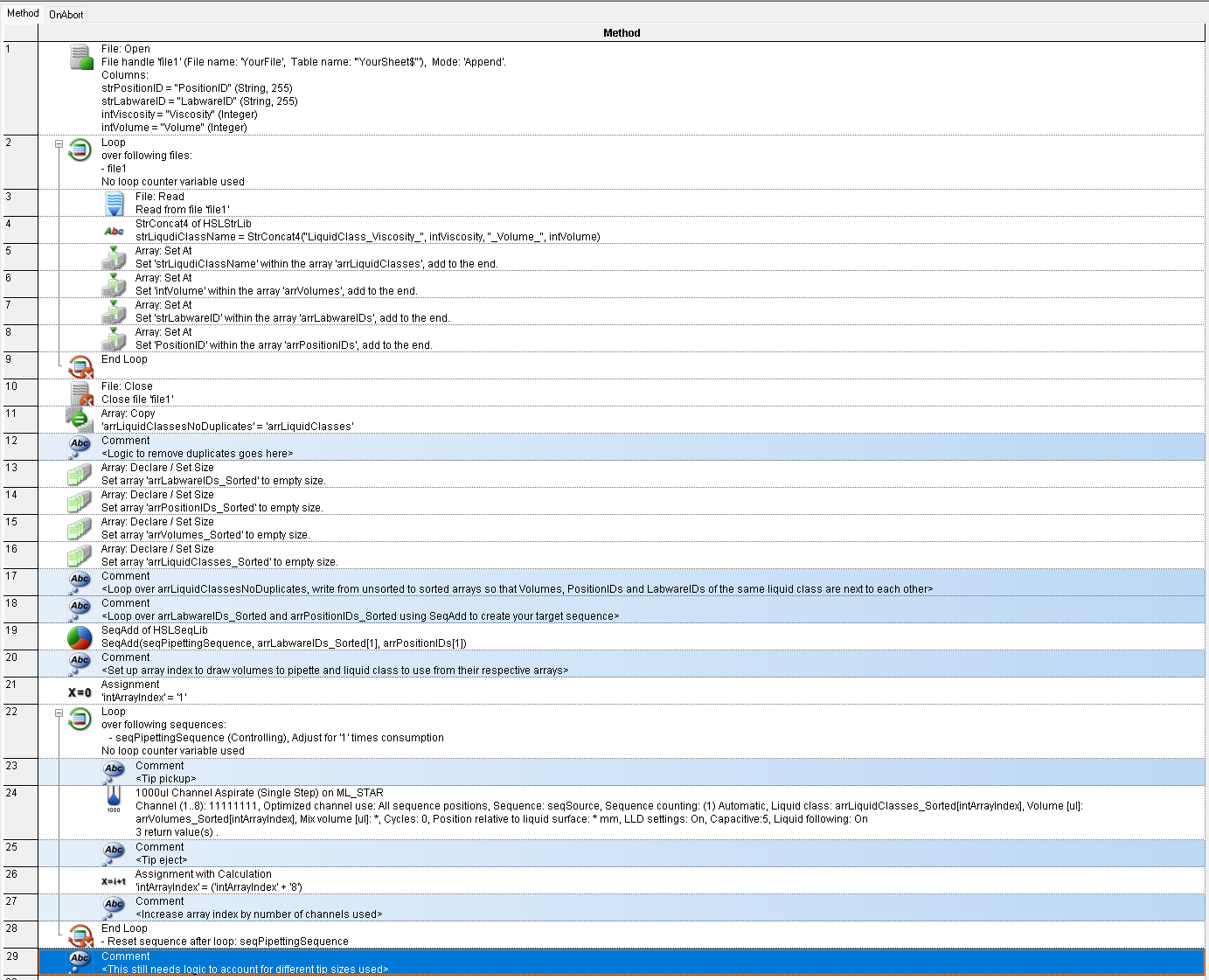

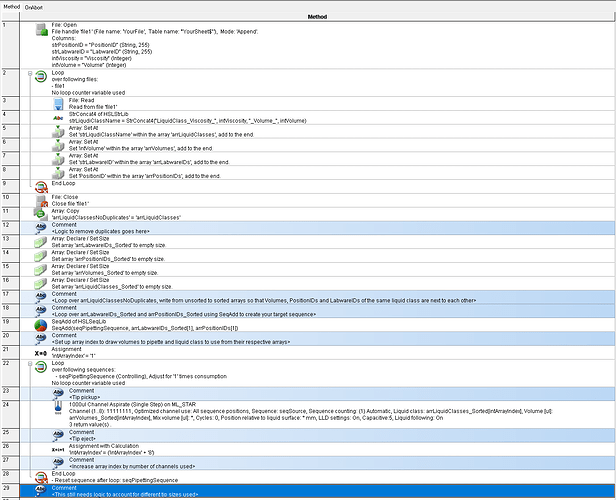

Hello @PatrickM, thanks à lot. I understand your point. Just to make sure I’ve got it right, could you please provide a visual example of the code? Thanks in advance.
I haven’t really got the time to set it all up, and I don’t know all of your specifics, of course. But here would be a general code example with comments:
