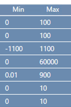

I was referencing this:
I am able to click into those min and max entries you’re showing in the formulas window and override the values. I just want to make sure that ability doesn’t let me break anything.
