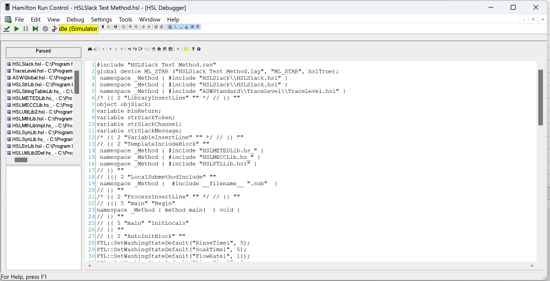

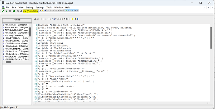

In Run Control: Enable the HSL Debugger with the Hamilton Support Software. In Run Control the files will be listed in the left hand side of the HSL Debugger Window
