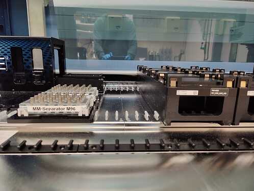

okay, okay, looks like I need to take a look at this ASAP. Just to confirm: My setup is like this:
I have PCR plates sitting on the magnets and have to aspirate from there. Since I can only use 300 uL tips I have to stop the aspiration after 6 columns to do the dispense to a falcon tube and do the remaining 6 columns. Will this work with the tools? I got the method already programmed with regular aspirates, can I simply replace those?
best
Dominik
Ah I see now. I am assuming you are multi-aspirating instead of using single aspiration steps. If this is the case, then I would suggest continuing with the standard aspiration steps that you have implemented. Pipetting Tools assumes single aspiration/dispense use and would lead to additional blowout aspirations between columns. With the MPE and low plate heights, the risk of crashing the channels is quite high as well for unmonitored transfers.
