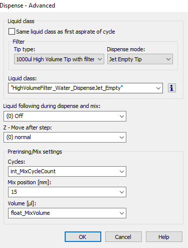

Here are the settings, @NickHealy_Hamilton. int_MixCycleCount = 0. Also I was wrong, it was minZPosition not minZerror.
@max_gildemeister - Your dispense height is higher than the pipettor traverse height, and almost certainly higher than the channel can reach with a tip loaded (not to mention likely higher than the height of the container from the labware definition).
50mL conical tubes should be much shorter than this, unless you are using some highly custom labware. I recommend breaking out a pair of calipers and double checking.
Thanks Nick! Yeah that value was from the position I got from training the 1000uL channel, guess it was too high. I lowered it and everything’s working.
