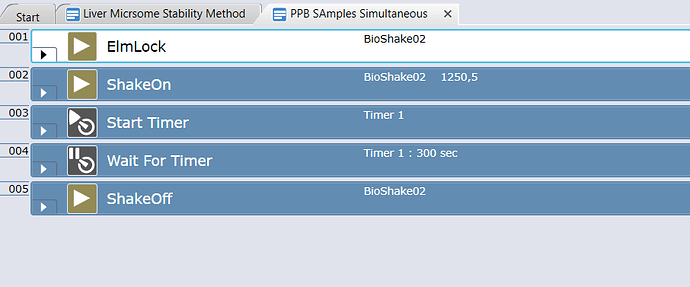

Yes, the subroutine, is just executing Bioshake commands to start and stop shaking after a certain time. I haven’t added the RGA movements to the subroutine because I gave the plates unique names because of their contents. However, if it will give me a better workflow to just number the plates and increment the index then I’ll do that, I haven’t thought about it that way. I guess the biggest thing I’m worried about with that is making sure the timing matches up on the main script and subroutine because I have aliquots at different time points to different plates. Then each crash plate needs to shake for 5 minutes and placed back to its cooled carrier. I attached an image of what I have in the subroutine so far.

One other thing I would consider is approaching the subroutines a bit differently. You might want to separate out the ElmLock and Shake On for the Bioshake as one subbroutine, and make the ShakeOff / ElmUnlock a separate subroutine. This would give you greater control over the timing, and in particular as your example shows Start Timer / Wait for Timer, if you handle the timers in the main script, you could then put other commands in between the Start Timer and Wait for Timer so that you have some other things running in parallel. As you have it here with Start Timer and Wait for Timer back to back without any commands in the middle, that is essentially equivalent to the single line “Wait” command.
