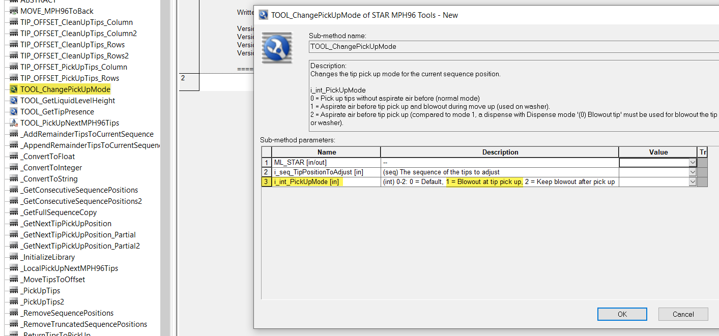

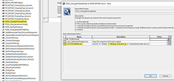

Using the MPH96 Tools library of the STAR Tools library suite, prior to tip pickup of the partially submerged tips, you can call the function ‘TOOL_ChangePickUpMode’ upon the particular sequence of tips. This will add/change a labware property of the tip rack labware, that will influence how the MPH behaves just prior to and during tip pickup from the specific rack.
If using tip pickup mode 1, as the MPH positions itself for tip pickup, dosing drive will have the plungers draw a blowout volume right before loading the tip rack, where the plungers will then force the blowout volume out while retracting in Z. This will ensure no liquid is present inside the end of the tip after retracting out of the liquid contained in the isolator (tip box lattice).
This value can be reset to default for the racks of interest if needed later in the run, but does not carry over from run to run.

@NickHealy_Hamilton I tried it and it works perfectly, even without having liquid in the container. Thank you very much, this is now my first “real” method that’s actually working to perfection!
