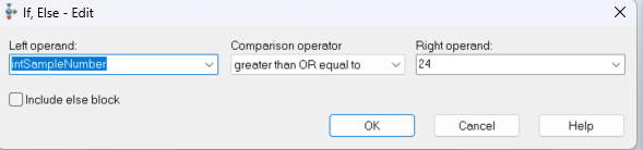

Hello, I’m looking for a way to create an IF statement that only applies if multiple conditions are met, rather than just one condition as shown in the picture below:
Does anyone have a way to accomplish this? Ideally I’d have 3 different variables listed as Left Operands, and if their Right Operands all met specific criteria then the nested commands would be executed.

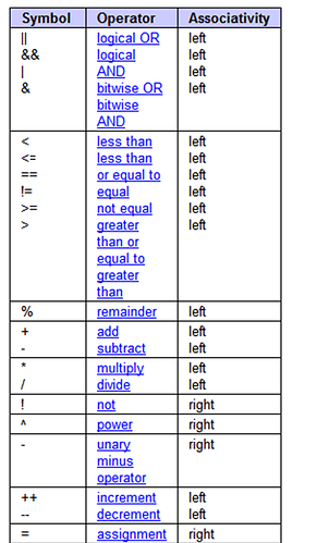

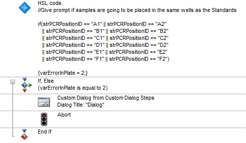

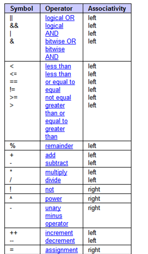

you can do it in HSL using the “&&” or you can nest IF statements together.

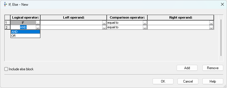

If you’re looking to upgrade, then VENUS 6 and above offers this functionality:
You can do it with HSL code and I do it quite often. We have Venus 4 but are about to upgrade to 6 so I’m excited to use what Eric posted.
