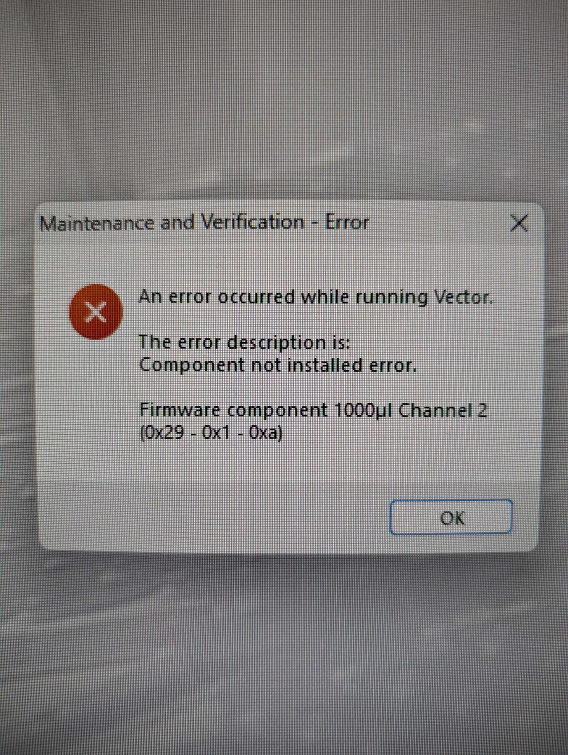

Need help installing new Hamilton pipet
Hey, we’re getting some errors installing a new pipette module for our Hamilton Starlet. There seem to be connection issue during the installation process. Basically the pipette module is not recognized by the robot however there is no issue when installing it in the second position. Does anyone have an idea how get around it?
