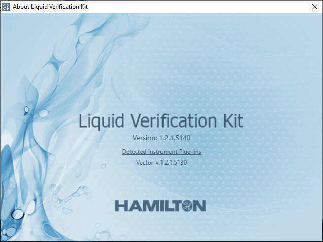

@EricSindelar_Hamilton is there a new LVK UI with the CORE II tip adapters already installed?
This is what we are running:

There isn’t a new UI update yet, but the Hamilton field applications team has updated the VENUS method that the UI calls out to. The method incorporates the CORE II adapters, additional tip types and layers, options to trace aspirate and residual volume, prompt to perform internal scale calibration, and bug fixes.
I’ll follow up with you separately with the method. If others have purchased the LVK and would like the latest method, please reach out to me directly.
