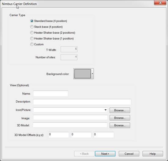

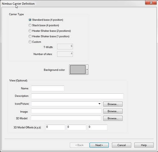

The NIMBUS HD carriers are modular like the MFX carriers on the STAR/VANTAGE platform so you have to build the carriers. This is accomplished through the Labware Editor. Open the Labware Editor and select File->New and then Nimbus Carrier. From there, you add the pedestals you’re using for each carrier type.
