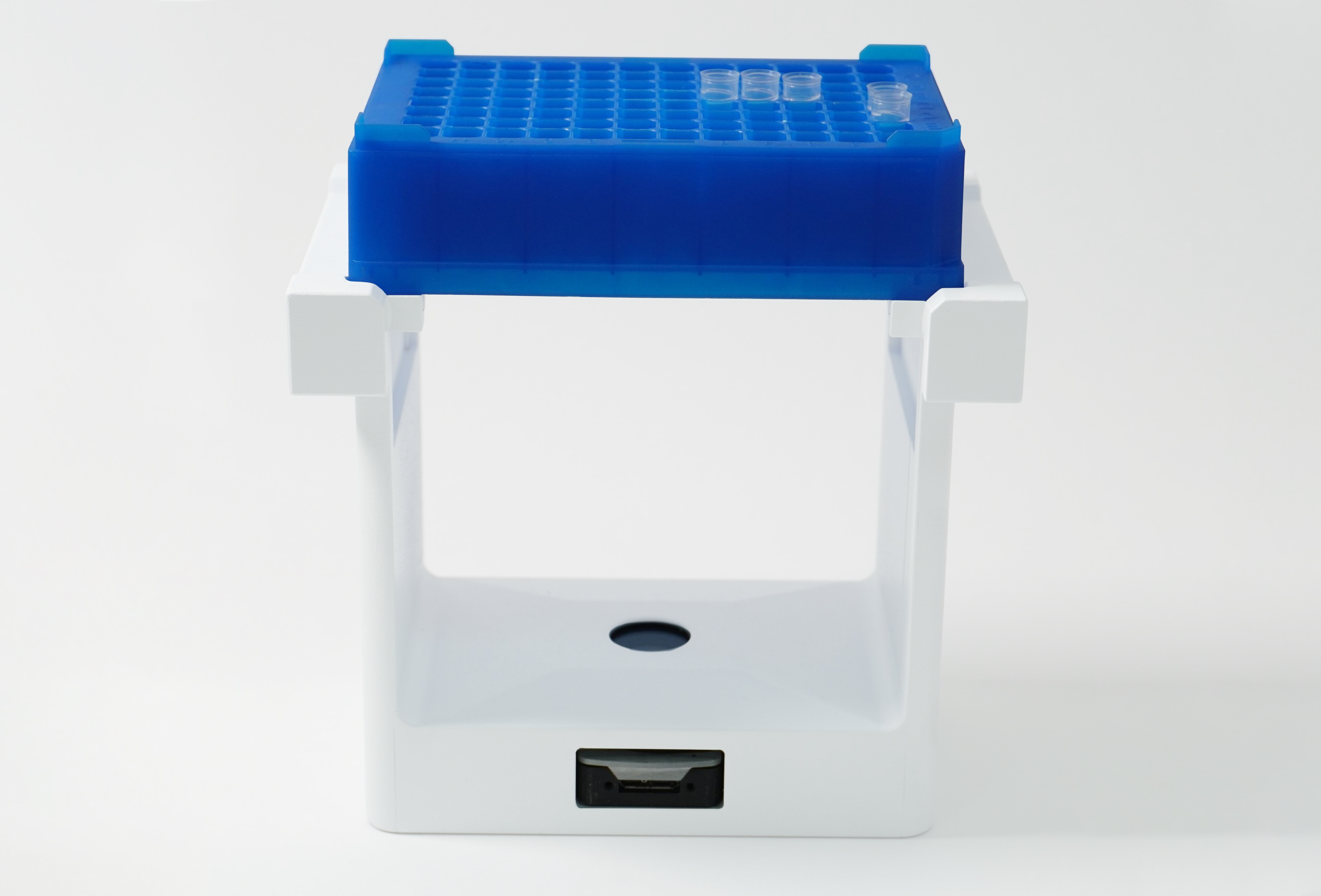

had success with KODA Sense
@Roooo Steribar have made some smaller more integration friendly rack readers, some of them only take up one position and double as an active position.

I don’t have hands-on experience integrating KODA readers into Hamilton VENUS myself, but I know of several people that have successfully integrated them with Hamilton liquid handlers using TCP/IP and VP Server.
If Hamilton has a KODA driver available, integration should be fairly straightforward. If not, KODA uses the same command set as the Thermo and LVL readers, so if you already have support for either of those in VENUS, it should be quite easy.
The integrations I’m aware of return the rack scan data, allowing you to compare scanned tube IDs against an expected worklist and confirm tube positions before processing.

The CO-RE gripper work just fine as long as you don’t need to rotate the rack. The Slim reader has the same footprint as an SBS rack so it will nest in any low level plate carrier without needing to be fixed, same goes for the compact reader but that one reads the rack while it’s being held by the gripper instead of placing it.
