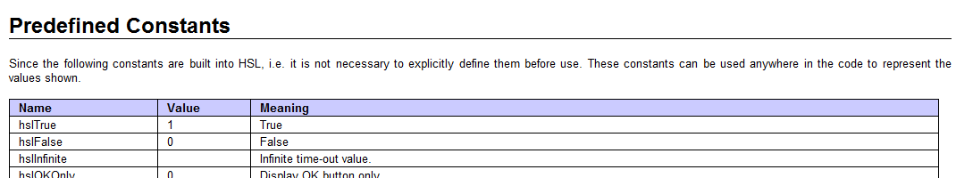

Great info on here. One question I have - does anyone know how to get an infinite timeout for the Join command? I have a process that I don’t want to have continue until a user clicks a dialog box in the forked submethod, and while I can just set it to a high number, I wanted to see if it was possible to have it be infinite.
Haven’t tested it but I assume a value of hslInfinite would do the trick:
100% forgot that hslInfinite was a thing. It seems to work - just tested it for a full minute and had no issues. Thank you!
