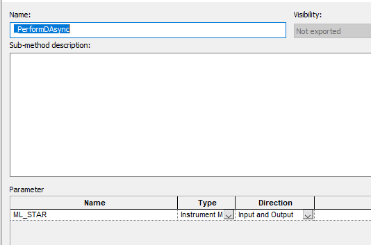

The problem is, since I want to use a firmware command in _PerformDAsync, I need the instrument passed to this function.
Within function “C”, I have the instrument as an input parameter, but its scope is local. The private function _PerformDAsync requires the instrument, but how can I pass it from “C” to “_PerformDAsync” ?

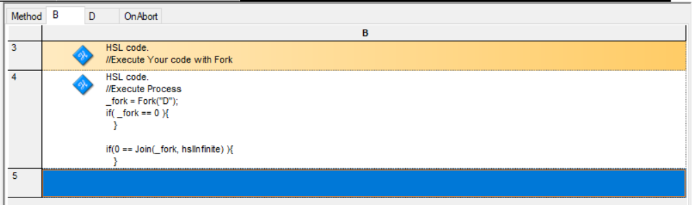

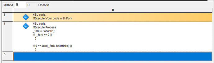

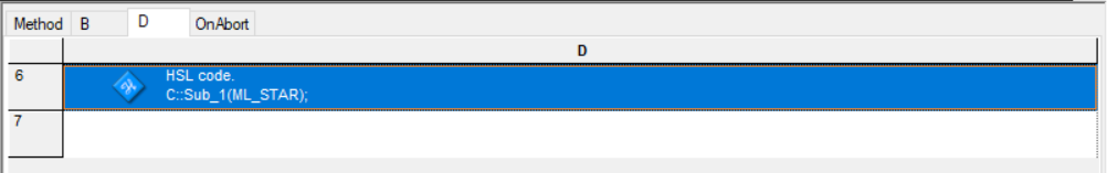

Here’s what could be done (untested code):
A.med contains a global variable of your parallel process, e.g _fork
Import your C.smt with device.
Create a D function, and call on C submethod in that function
In B, execute your code with fork command calling D.

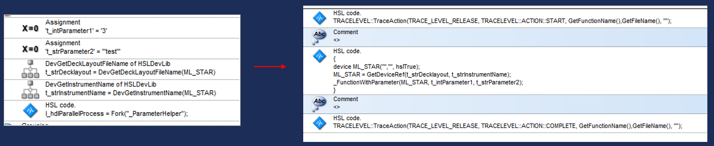

You could do as follows:
Left side would be the function in your smt where you could pass parameters to (hard coded here). You then put them on task locals (also the ones you need to grab the device reference in the parallel process). The you fork your actual parallel process which is shown on the right (whithin the same smt).
As has been mentioned, logic may have to be added to prevent parrallel access to the same device if it’s physically impossible.

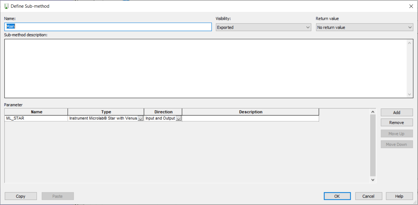

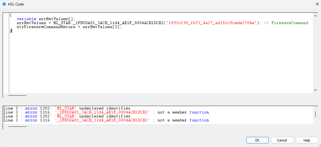

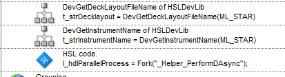

One issue still exists though. When I remove the instrument from the input parameter list, the ML_STAR functions (including sending a firmware command) is not available anymore and I get the syntax error for the respective line (see image)

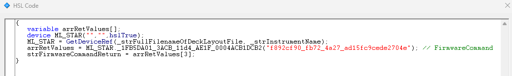

I could solve the syntax error by initializing the ML_STAR object within the same HSL code part as the firmware command:
But still I get an error during runtime for this line saying “bad argument (0x23 - 0x1 - 0x34)” I guess I am missing the link between setting a firmware command via method editor using Command and Parameter
and the way to do it in HSL code. Do you have an idea?
I see, in case you want to still use functions from the toolbox instead of pure hsl, I would do as in my example and just call your actuall function with the device as input parameter from the function that’s started in parallel. In my example that would be “_FunctionWithParameter(ML_STAR,…)”. In “_FunctionWithParameter” you’d then see all ML_STAR steps as usual.
So in your initial example:
_intAsyncDHandle = Fork(“_Helper_PerformDAsync”);
and in _Helper_PerformDAsync you would then fetch the device ref and call _PerformDAsync with the device as input.
I hope that’s somewhat clear :slight_smile:
I hope I understood it correctly, but if I define _Helper_PerformDAsync with input parameters (e.g. ML_STAR) and then call the function using
I get a underspecified actual parameters (0x23 - 0x2 - 0xd) error
The fork function, however, cannot take more than one input parameter…

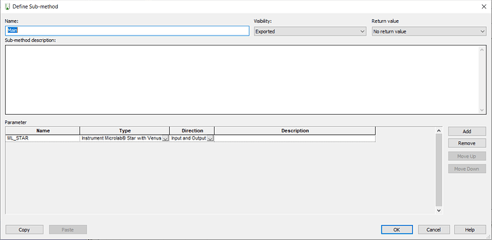

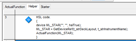

That’s not how I meant it, I try to explain better:
You need 3 functions, one without input parameters, the others with the input parameters. I’ll list them in calling order:

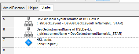

StartAsyncTask(ML_STAR):
This starts the helper as parallel task. The helper fetches the required paramters and calls the actual function (which can also be in a different smt, e.g. on layer 3).
_Helper_PerformDAsync():

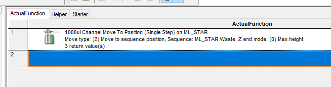

Function that’s called from the helper and in which you can use the STAR steps:
I hope this explains it better
This was perfectly explained and should actually work, but I still get a bad argument (0x23 - 0x1 - 0x34) error in the line where I want to call the ML_STAR function (no matter if it is a firmware command or a LoadCarrier (single step) function). Did you try calling an ML_STAR function on your computer?

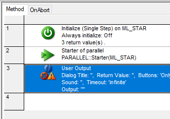

I have tried it, yes. My method:
Cooresponding smt functions in order of calling:
Starter(ML_STAR) //device as input parameter
Helper() //no input parameter
ActualFunction(ML_STAR) //device as input parameter
If you are getting the “underspecified paramters” error, there is still a bug where you try to call a function without passing the correct amount of parameters.
