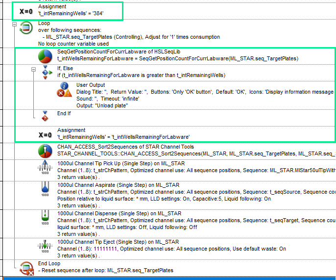

There is a function within the HSLSeqLib called SeqGetPositionCountForCurrLabware. Assuming your 384 well plate target sequence is at least grouped by labware (all positions for that target are together) this function will return the number of positions left for the labware in the current position of the sequence. You can use this to monitor the number of positions left and show a dialog when the count increases (moved to the next target labware). See example below:
I start with the remaining wells set to 384 (max for the target plate). Every loop it gets the position count for the labware. As long as this number keeps going down, the if statement lets the pipetting happen. As soon as the number goes back up, it triggers user output to pause the run.

This worked perfectly, thank you!
