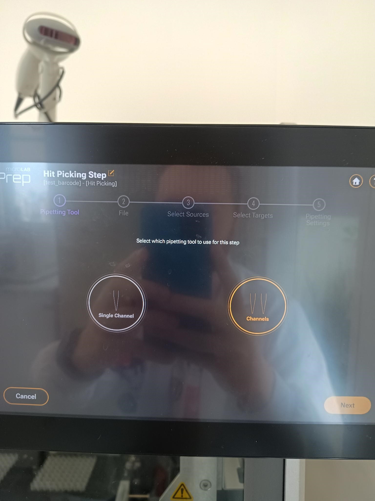

Thanks for your help. I followed your advice and tested using the combined functions of Hit Picking with barcode reading. What I observed is that the Hit Picking function is not enabled for transfers with the 8-channel multiprobe we have, which would make the protocol very slow.
Ahh, I wasn’t aware you were doing this with the 8MPH. Right, as you saw, hitpicking is only available with the independent channels at the moment (as of v3.2.2). The worklist input file becomes a bit unruly to validate for use with the MPH so that functionality is still slated for a future release.
The wait step you have in your screenshot isn’t a bad path to take for a prompt to your operator, but it isn’t as elegant and programatic as being able to read the barcodes and then validate them against the worklist input file.
