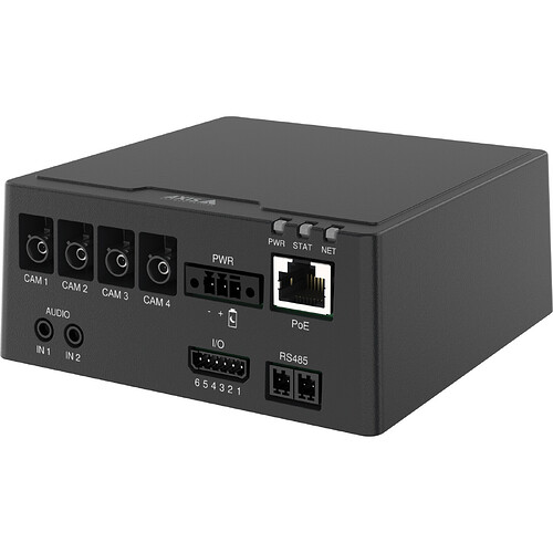

Switch
Cables
IR Camera
Fish Eye Camera
Regular Camera
Magnet Holder
Mounting Stand
Blue Iris
We’ve been setting a bunch of these up lately. 3D printed covers for them. Maybe not computer vision grade, but useful for monitoring. We also had some IT constraints and could not have microphones or any cloud streaming services.
Hat tip to Reed Kelso for the suggestion originally.
