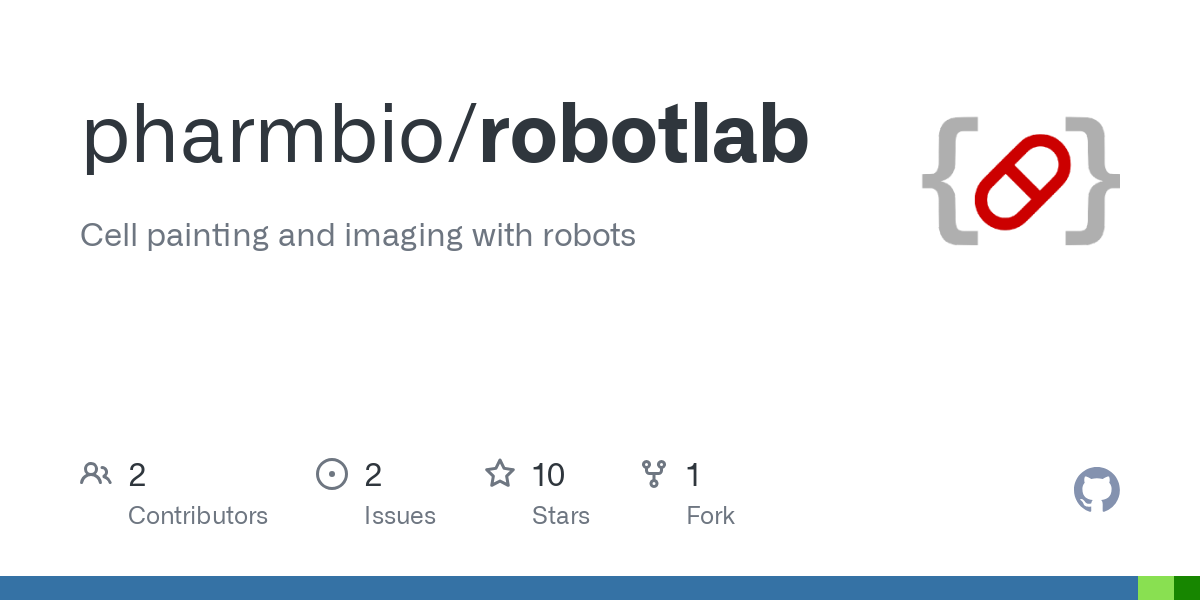

Found this quite inspiring example of integration, well-written and with minimal overhead
Biotek washer/dispenser
Liconic Incubator
Bluewasher
PF400 (they needed to provide custom flashing to avoid finicky telnet connection) + 8bot arm (this one puzzles me)
Imaging, including Nikon
Wow thats a really great repo!
