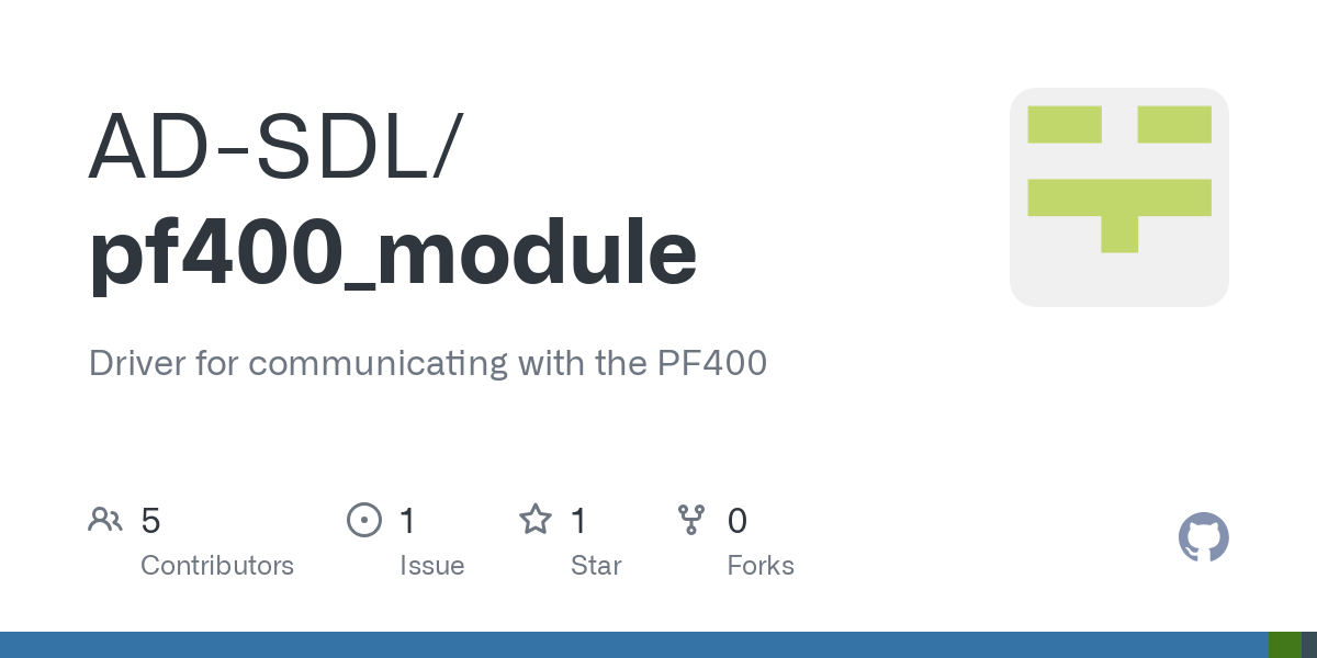

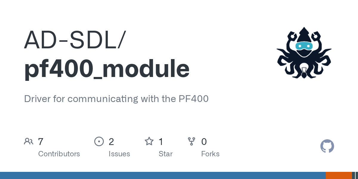

In particular, they seem to build python-driven workcell with several arms including PF400:

Python-based code for an actual driver, if possible.
I don’t put this at doubt. Thread you point is a nice demonstration that approaching company contacts may bring no result. Example: I had zero reasons to go through this loophole with OT2 because code and examples are available.
Now, you say there is interface that is actually used by GBG customers (contrary to saying - fk this, let’s buy another equipment) and available for years but with zero usages at github? I am more likely to believe in mermaids, sorry :slight_smile:
I see some unofficial code in gitlab, but I don’t see any official confirmation of support. Nuget packages are also not official.
Pylabrobot uses USB interface not SILA client - assume you folks not ready to rely on this, but maybe I am wrong.
Now, you say there is interface that is actually used by customers (contrary to saying - fk this, let’s buy another equipment) and available for years but with zero usages at github? I am more likely to believe in mermaids, sorry :slight_smile:
I’m sorry what is this referencing?
This is the Fluent Python SDK (also on GitLab) which labs do use.
