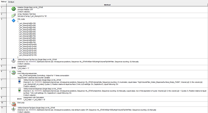

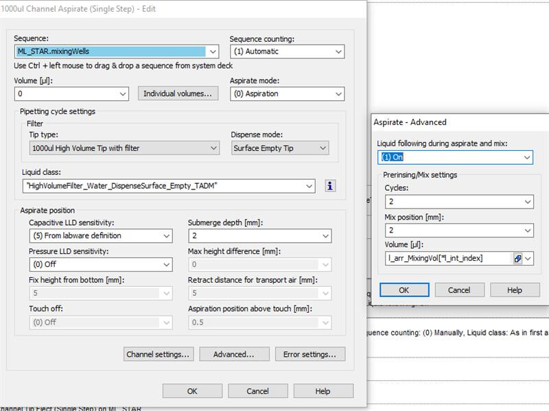

I’m measuring multiple wells’ liquid z-height and using that value to determine a mixing volume for each well. This mixing volume is stored in an array. If I pass the array as I do in the below image, does anyone know if this will result in a different index of the mixing volume array being used for each channel, or would all the channels use a single index from the array?
@EH421 I pass the array using [ * ] only to mix with different volumes. In your case I would use I_arr_MixingVolume_uL[ * ] ( no spaces between the [ and the *)
Thanks for the response. I did some testing with your suggestion but only using [ * ] results in the mixing occurring with the first set of values from the array. eg If you have 8 channels, only the first 8 index of the array seem to be used for all of the sequence.
I retested with the code I have above passing an array index (l_int_IndexStart in the image above) and in this instance, the mixing volume changed dynamically with the array resulting in a different mixing volume for each position in the sequence relative to the index of the mixing volume array.

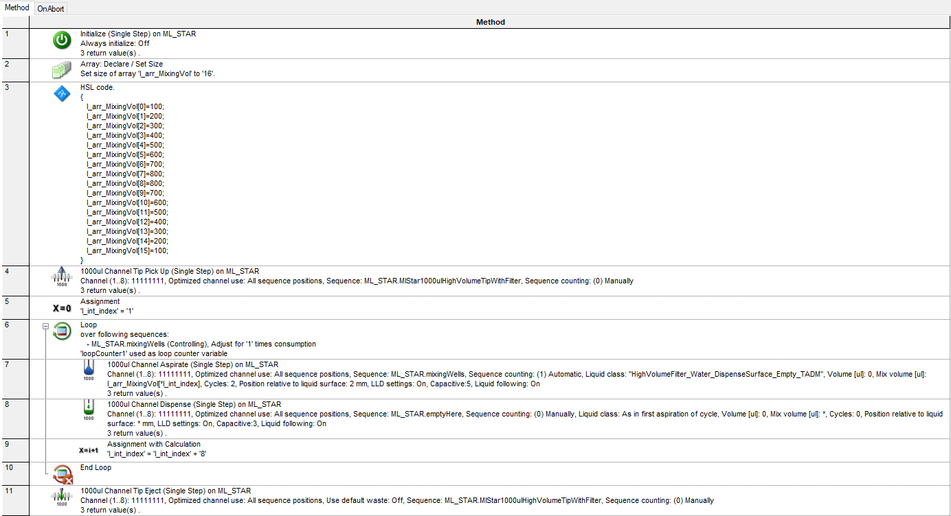

I wrote the below method to call an aspirate step with 2 cycles of mixing and passed the l_arr_MixingVolume array as the mixing volume. When passing the array I also pass the index for the value I want to mix with in the array.
My expected results are to see the left-most well mix with 100ul of volume, and increase by 100ul until the right-most well (800ul mixing volume). This is being set in the HSL code in the method. Upon completing the first mixing, I expect that the opposite will occur (800uL mixing volume in the left-most well, down to 100uL in the right-most well) again as set in the HSL code.
I then ran the method and record the wells to ensure that they were mixing with the volume set and they were by recording and reviewing the mixing steps. I’m unable to post a good photo or the video due to size restrictions, but I was able to verify that the mixing volume was using the expected array index value with this code.
