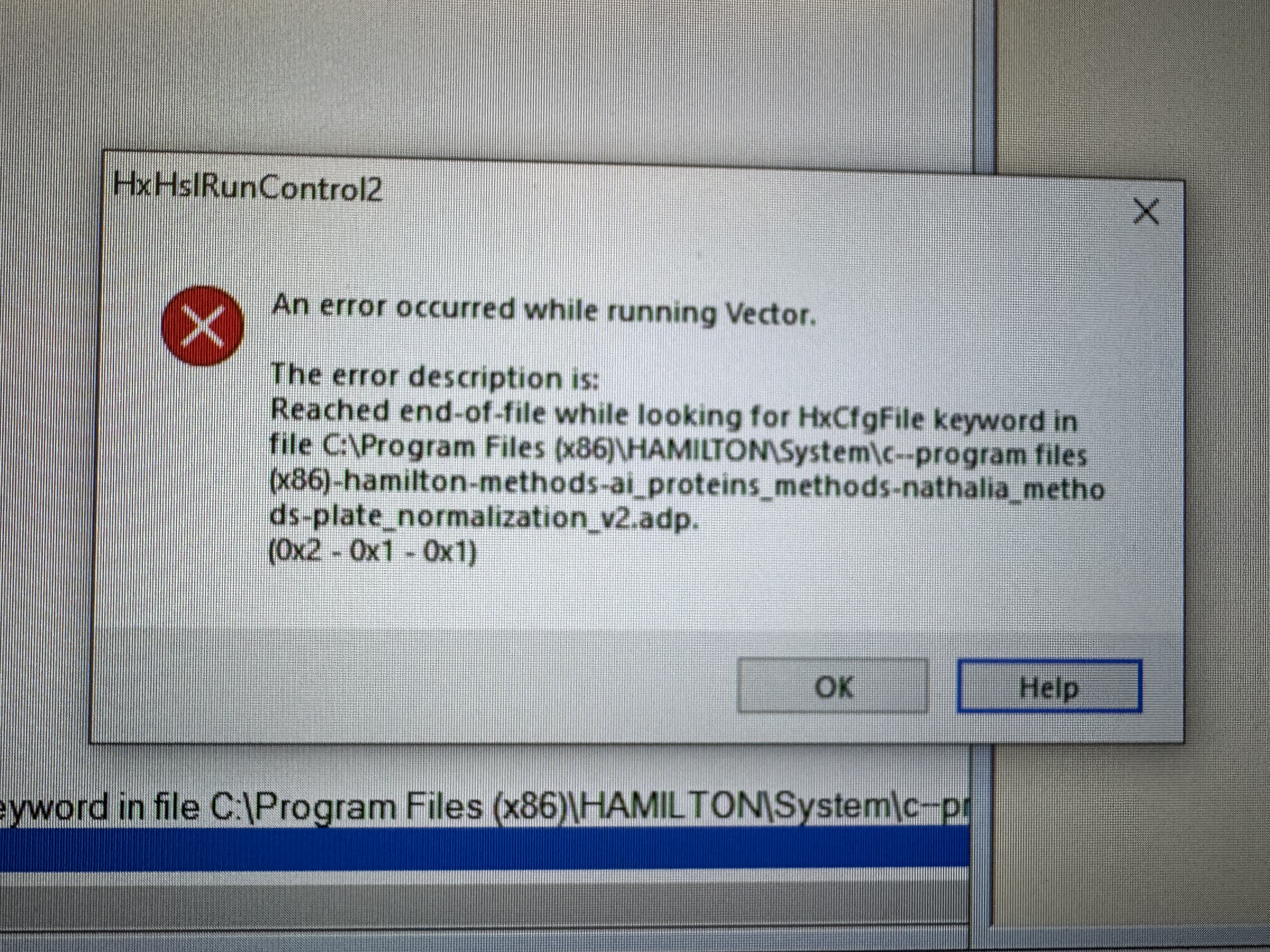

Sorry for the ping, but I ran into this unexpected error that I do not know how to resolve. One of the methods I am trying to run encounters an error at the end of it (see below):

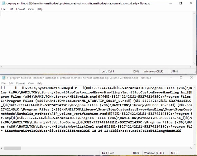

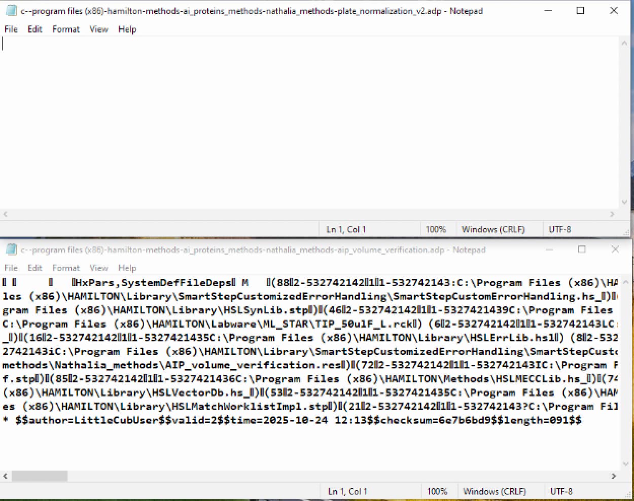

Looking into that file, I noticed that it is blank, unlike the other files, causing the error, but I am confused as to how this could happen and how to fix this. I tried overwriting the method again to see if it would propagate automatically, but no.

I can’t explain why this file is an experiencing an issue, however, to resolve it you can delete the .adp file and run the method. A new .adp file should automatically generate by the end of the run.
