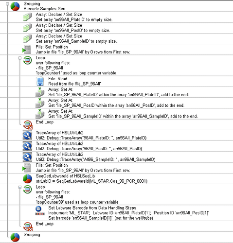

Hi Matt, I figured I would ask this here instead of making a new topic - is there a way to add sample barcode names to the mapping files? We have individual tubes with barcodes that scan into Excel as A01234 (all the barcodes are unique for each tube) and then the contents of these tubes are transferred to a 96 well plate. Thats when they are loaded onto the STAR, but the STAR never scans the individual barcodes since the tubes are never loaded onto the robot, just the 96 well plates. I know there is a source position barcode option on the mapping file customization, but I’m not sure how to use it. This is how the worklist looks, but we only use the PlateID and PosID to make the pipetting sequence, so I’m not sure were the BarcodeID would fit in. Thanks in advance!
PlateID PosID BarcodeID
Cos_96_PCR_0002 A1 A01234
Cos_96_PCR_0002 B1 A01235
Cos_96_PCR_0002 C1 A01236
Cos_96_PCR_0002 D1 A01237
If you want to work around the limitations of the Hamilton sample tracking database, you can always simply build and manage your own arrays with sample barcodes/data throughout the run, then build a custom export through the file handling operations.
I typically prefer this approach as it provides maximum flexibility, but of course use cases vary.

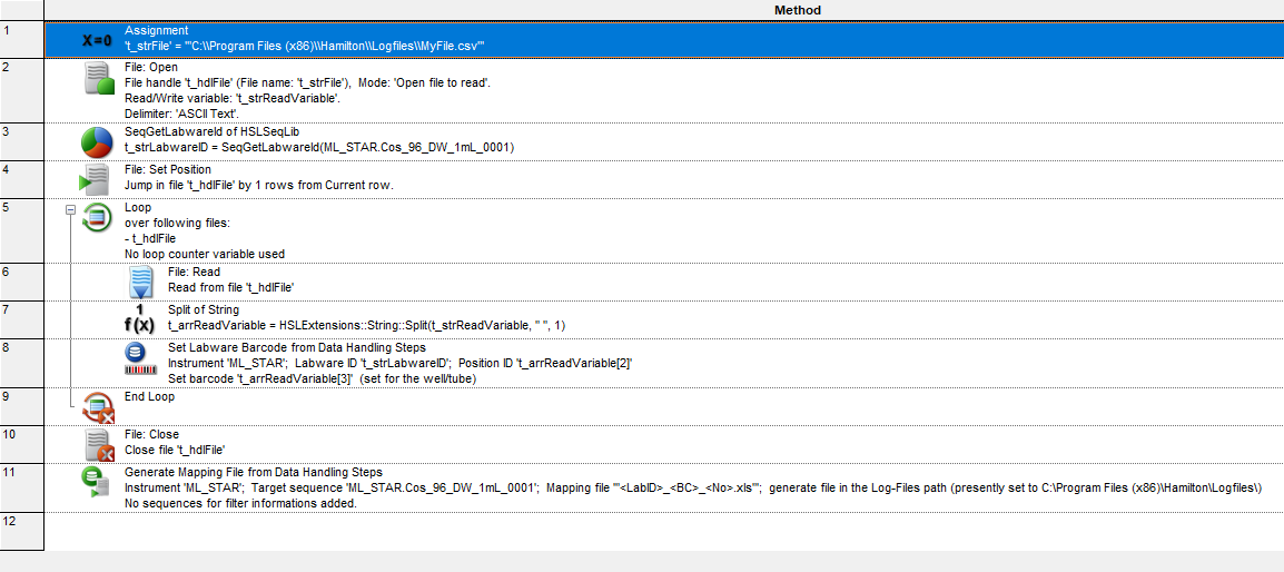

Hi @InnerKK,
This is quite easy to accomplish. You have a .csv of data including barcodes of samples for individual wells of a plate. Obviously when and if the autoload loads the target plate it only has the capability of reading the physical barcode that could be on the side of the rack - reading possible barcodes on the container level isn’t going to happen. So the process would be to read the csv with the general steps file handling commands, parse the contents of the file, and assign the barcodes manually to each position:
In the example above the file can be in a variable or it can be selected via a custom dialog. Then the file in question is opened in your choice of format - my personal preference for any text based file is ASCII. Jump past the header row and loop over the file reading each row as a single long string if you use ASCII - the read command returns the entire row as a single variable (in the example above its l_strReadVariable). That variable will be equal to “Cos_96_PCR_0002 A1 A01234” per your file example above. You can then use the Split command of the HSLExtensions string library to split the string into its own array where values are separated by a space (“ “). Thus your string becomes an array of 3 values where the first value is “Cos_96_PCR_0002”, the second value is “A1” and the third value is “A01234”. Finally assign the barcode to the labware ID in question at position array value 2 with barcode array value 3. And since you are looping over the file each row with data winds up becoming a barcode assignment. In no time at all all positions within the file are accounted for and a subsequent generate mapping file command will show the barcodes:
Please keep in mind that this is a very simple approach to transferring barcodes from a file to containers on a rack. It assumes that the file contents are exactly as specified where each row has 3 values separated by spaces and no more than 2 spaces on each row. It also assumes the contents of the second value on each row is always going to be the correct alphanumeric value that corresponds to the labware definition on the deck layout. Deviating from this without error handling or more data handling could result in errors.
I hope this helps!
Matt

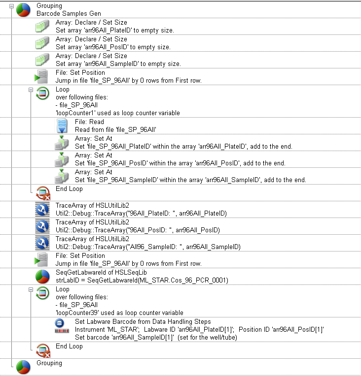

Hi Matt,
This is perfect, thank you so much! I’m trying to get it to work with an .xls file because that’s what I’m using in other places in my protocol, but I’m having a difficult time getting it to work. I feel like I’m very close, but its stuck in a constant loop and not progressing forward in the arrays (so its only assigning A01234 to plate 1 A1 over and over again).
Never mind! I fixed it by adding a variable for the array index and then increasing it by one in the loop. Thanks again for all your help!!
