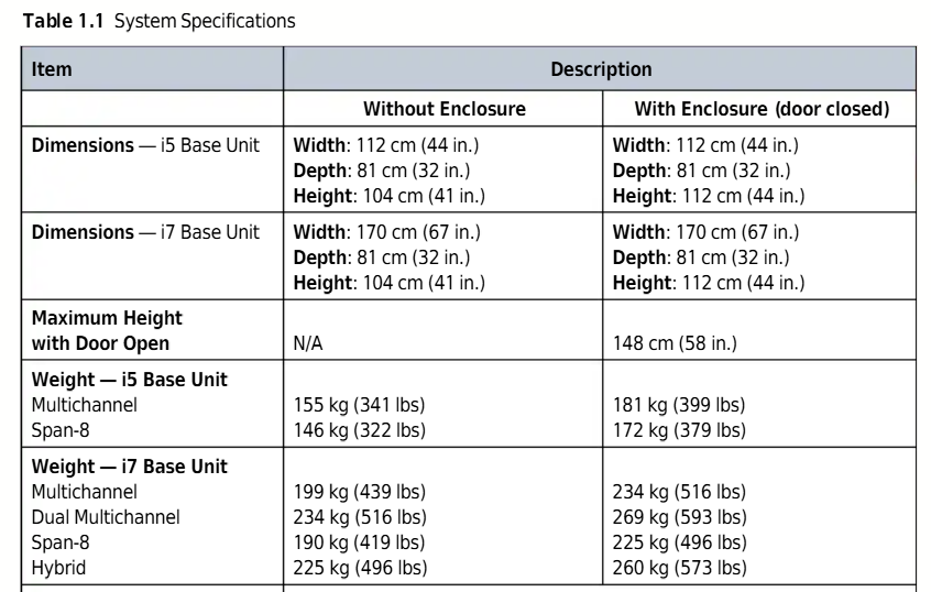

For the i7 part the site preparation document states that “Weight — i7 Base Unit Hybrid 260 kg (573 lbs”
I am kind of lost with these biomeks. Obviously it is equipped with a lot os ALPs, shaking, cooling, washing devices+ an ABI automatic PCR which will add some weight, but still not enough to add up to 260 kg…..
What am I missing?
Eh, I could see 260kg with everything installed and an enclosure like they say. I haven’t moved anything since a Biomek FX and I doubt the Biomek i7 is lighter than an FX. I’d put the FX around 250lb. We could move those around with just two people but they were all you wanted. The i7 is larger in every dimension as far as I know. I’d for sure want three strong people with an i7, but the real problems is lift points. If possible I’d use a rigging company, which for this will really just be strong people whose job is to move things around.
