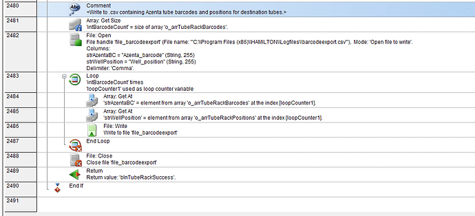

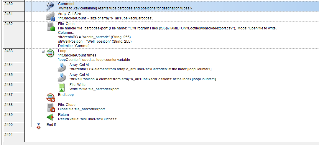

Relatively new programmer here but this can be done through the ‘File: Open’ single step, and looping over the variables you want to write with the ‘File: Write’ command. Here is an example I just worked on today to generate a barcode export report containing destination barcodes and well locations as a .csv.

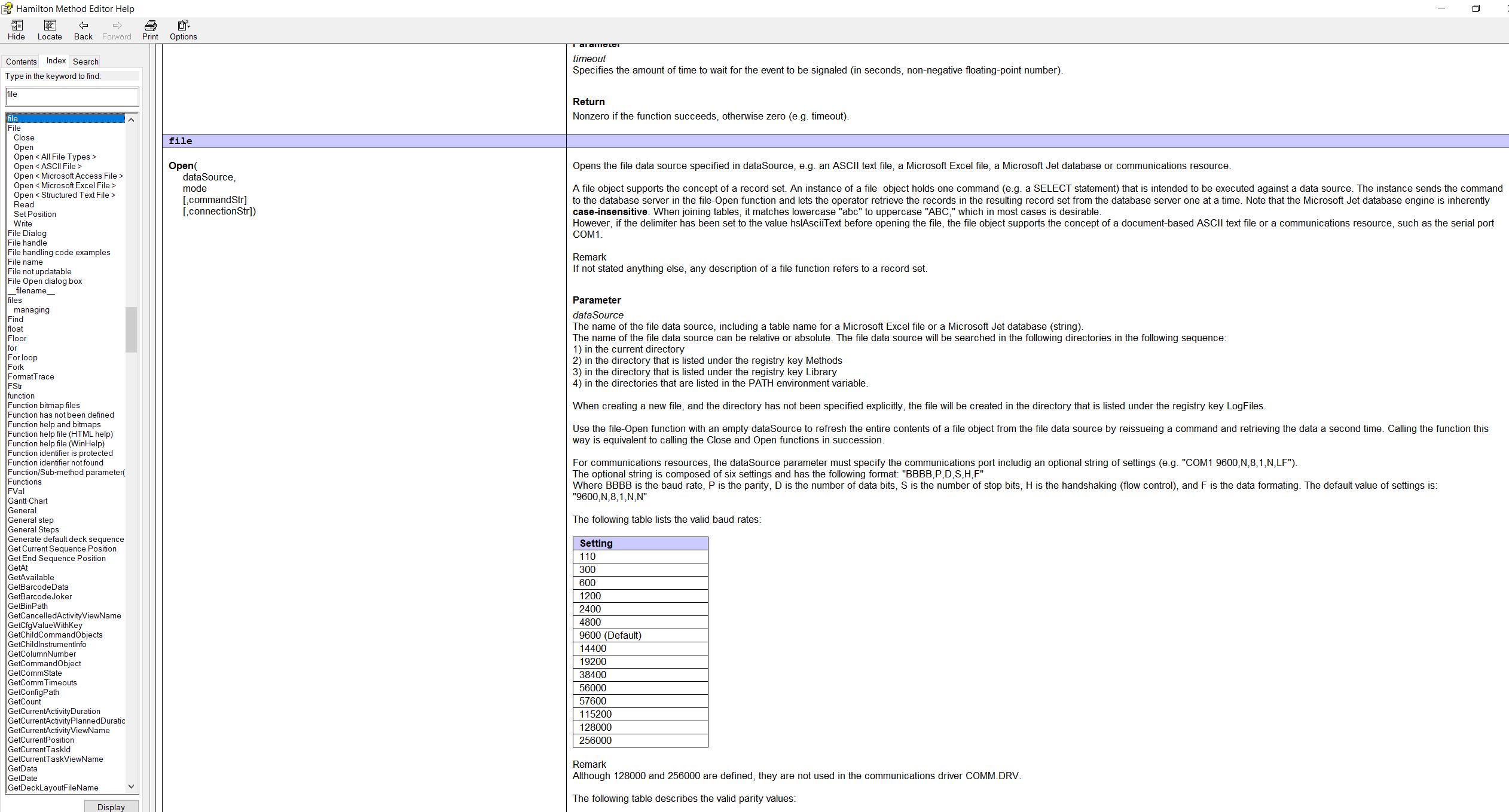

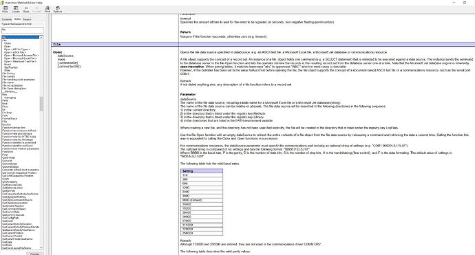

If you’re in method editor and go to “Help” and then “Help Topics”. You can search for file and will find all of the file commands in HSL. Venus supports .xls, .txt, .csv, .tab, & .asc files. It’s good to read this information to fully understand the capability however, there are also the file handling commands as shown above by Desert_platypus under general steps that are simpler to use.

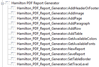

There is a new library that was recently released (yesterday) exactly for this purpose. The Hamilton PDF Report Generator can be downloaded at this link, and can be found in the Library Downloads section for future reference.
A list of available functions can be found below. In general, the process consists of creating a New Report, adding desired text/objects (Header/Footer, Images, Tables, Text), then Save Report.

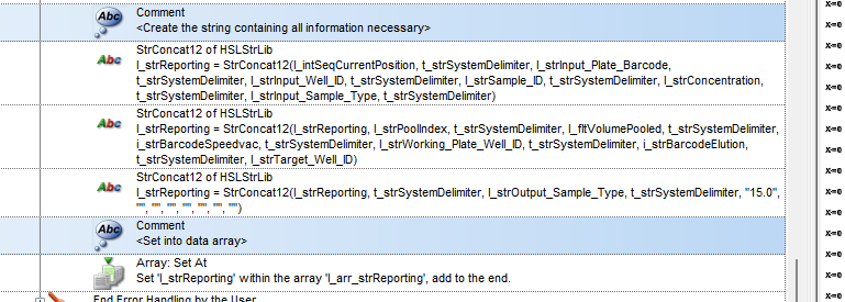

Depends what you wish to do, personally I am a fan of a .csv to be generated, not all PC’s in our company have Excel installed and some users are running on other OS-es so text-based is the way to go for us.

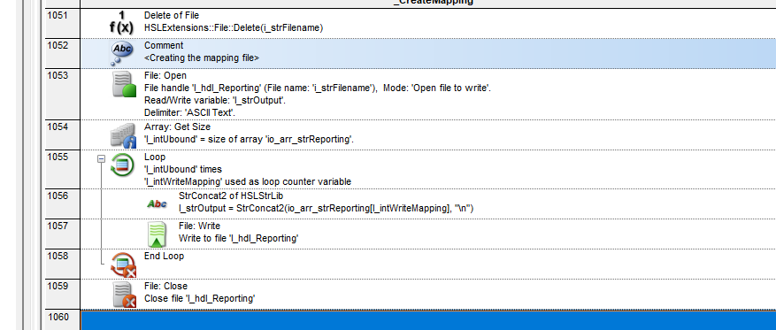

One of the things I simply create is a string and at the end of the method I simply generate a report
Followed by
Simply…lovely

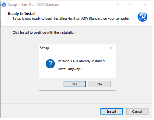

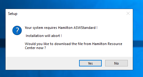

Hi, we managed to get PDF reporting to work on our personal computers.
However, we’ve run into issues during installation on a computer in the lab, which does not have access to the internet. During the installation of the “Hamilton PDF Report Generator” library, the installation of “Hamilton ASWStandard” is also required. We had installed ASWStandard manually. However, when we tried again to install the PDF Report Generator, the following message was displayed: “Your system requires Hamilton ASWStandard,” and the installation was aborted.

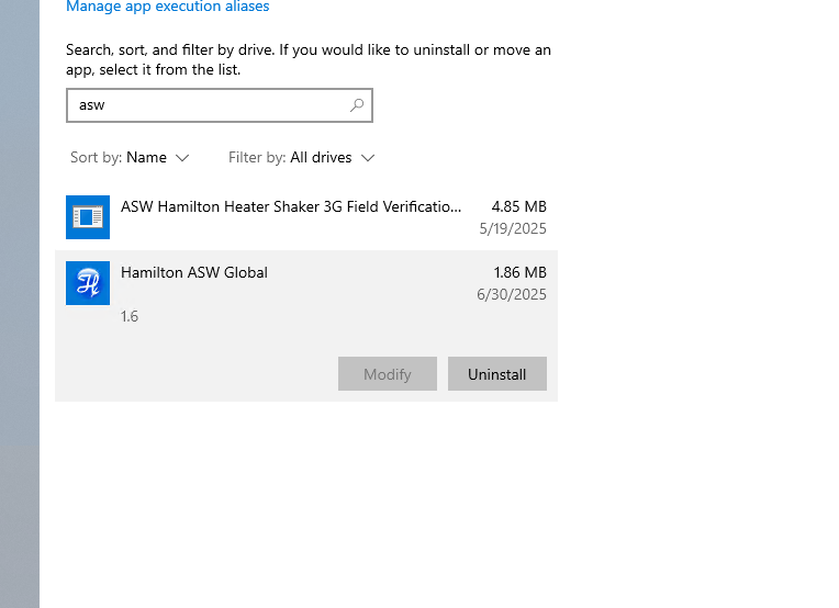

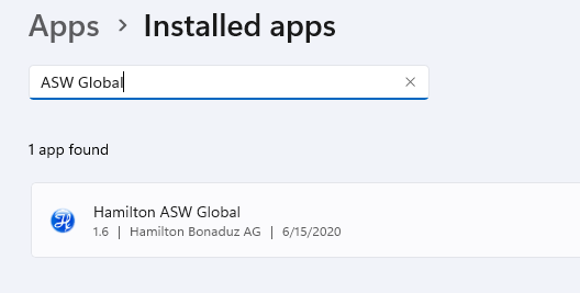

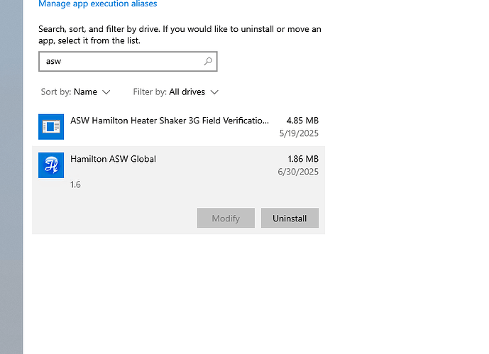

Hi @Tilen ,
Can you take a screenshot of your ASW Global that is currently installed? See below for an example:
It’s possible you have an older version installed.
