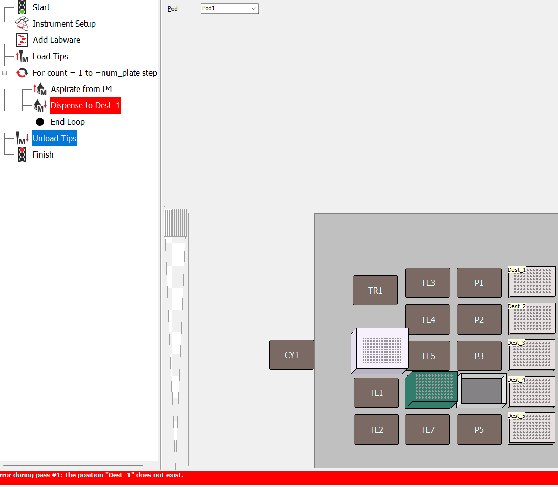

  • Can we call the labware by the labware name in a dispense step? I got the “does not exist” error.

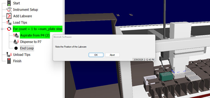

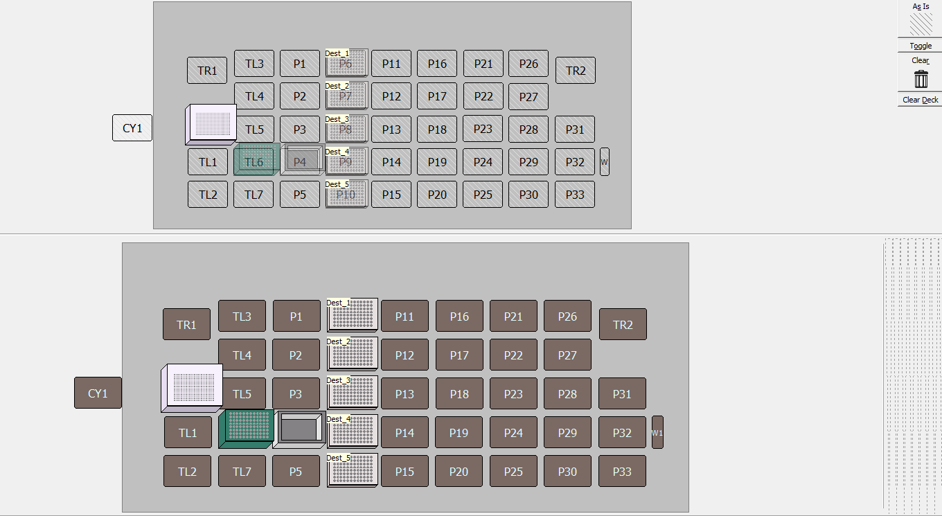

It worked and added the plates to the deck but when I try to call it in an dispense step, it says "The position “Dest_1” does not exist.
When I changed the position to “P7”, it will simulate, but every time it tries to use that labware, a pop-up window appears asking me to confirm labware.
Is there a way to skip this pop up or is there a way to ask user to confirm the deck layout after creating the plates in the script?

Labware.DeckPosition(“Dest_2”) also return the “Dest_2” does not exist error, but I can get by it by calling it P7 - maybe the name is not recorded? but it does show up on the deck.
I may try on an actual machine soon, but on simulation, it seems to know that the plate wasn’t there during “instrument setup” and keep asking me to confirm the labware is there.

You are right, the message is not from Biomek. I’m using someone else’s testing liquid class - the pop-up window is from their pipetting template :woman_facepalming:

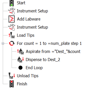

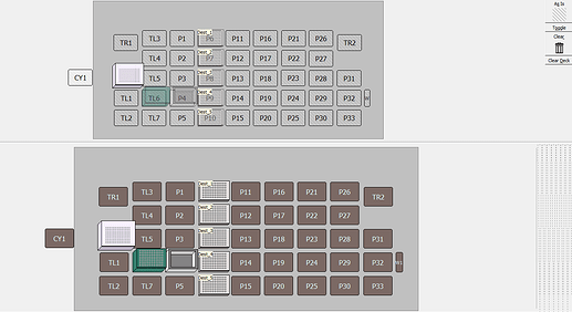

And I was able to add another “Instrument Setup” after my script to confirm the deck. It is a simple thing - click the “Toggle” on the right side… This also clears the “Dest” does not exist error, so the script seems to be working and I’ll keep testing it!
The method is something like:
