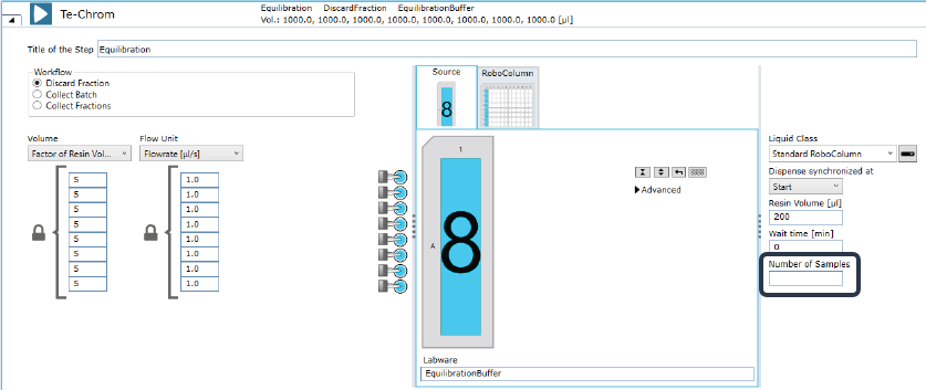

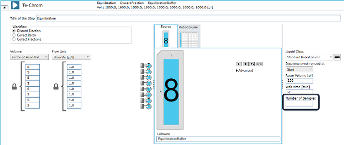

Hi, I’ve now managed to get all the different components of the Te-Chrom module working, and I’m trying to optimise my script so that I can simply enter the number of samples in the touchtool and the script will work out how to apply this to the script for each step. I think I need to set variables, if commands, loop commands, etc. As well as making clear touchtool script lines. but im already stuck on how i can manage this within the te-chrom smart commands. Has anyone made a script like this before and has any advice for me?
Have you already tried to apply your variable in the field Number of Samples below the liquid class at the bottom right of the TeChrom script command?

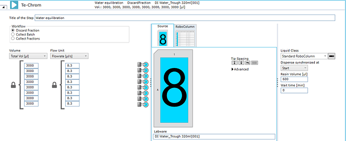

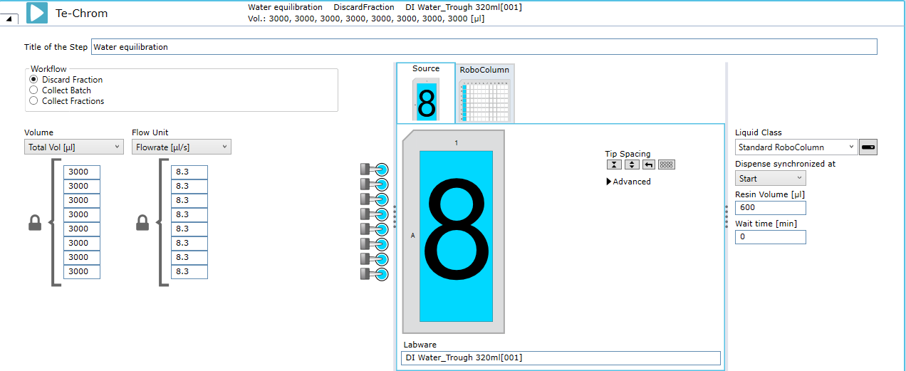

Hey, thanks for your response! That box is not present in my smart command…I only have until ā€œWait time [min]ā€. Can you send me the manual that you found this in? Does it look like this on your FluentControl?
For example:
it is likely you will need a FluentControl upgrade to > v3.7 to get the latest Te-Chrom smart command updates
My screenshot came from the manual of the latest version FC 3.8 SP1 (or go to FluentControl Help in the Menu). Probably it is a setting that was added in a later version.
The ā€˜Number of Samples’ field is shown in the screenshot of the manual since version FC 3.6:
